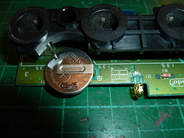

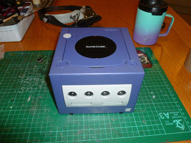

    Hi
    I just picked up a GameCube off eBay using some of the money I made selling the C16 & Dragon 32 to Allen. The Cube has a battery backed up clock to keep the time/date and settings. The batteries are now over Twenty years old now and will be failing at best or at worst leaking which would destroy the PCB. The battery is soldered direct to the game controller sub assembly and in this case it wasn't loosing the settings but the clock wasn't keeping up to date. When I removed it the voltage was 0.24V instead of 3.3V.

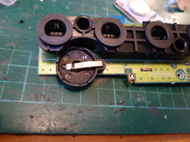

    So the battery needed replacing which I did this morning but I fitted a battery holder so I can replace the battery easily in the future.

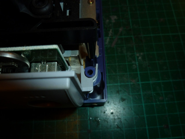

  4. Vyper68
    Here are some photos of the process step by step. Had to do a bit of fettling to get the battery holder to fit flush but got there in the end. Time and date are held correctly now so should be good for another Twenty odd years. Need to look at the SD card solutions for the GameCube at some point.
