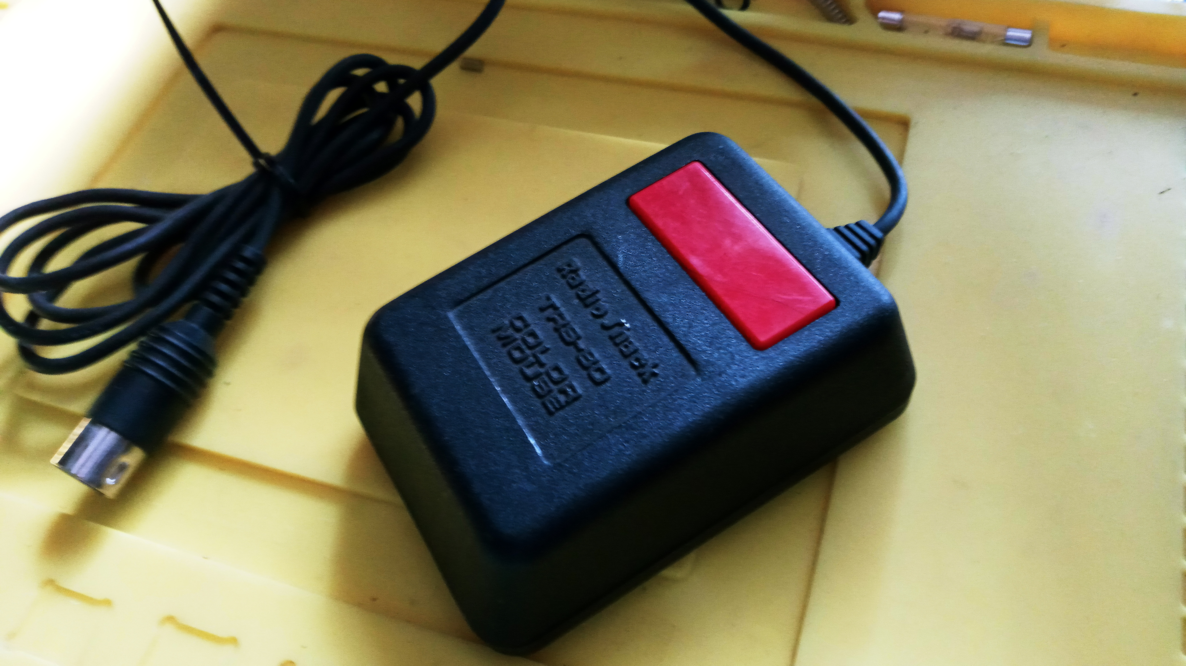

    So the light went on in my head right away when I found out the TRS-80 color mouse was analog, that I could convert it to Atari 9-pin port and use it in place of a touch tablet when I want too. And the TRS-80 mouse's case shape just happens to match the Atari 800 and peripherals just like the ST mouse's wedge shape matches the XL and XE computers wedge shapes. So the TRS-80 mouse will look good with the 800 and like it was made for it, once I paint it tan to match the 800 line's color scheme...and sand off the TRS-80 raised lettering and replace it with an Atari badge. I think I may paint the red mouse button yellow like the 800's start key too. And of course, the TRS-80 mouse will be naturally compatible with the legacy Atari software that uses paddles and touch tablets! I not only can use a mouse with these great programs, but the TRS-80 joystick just might work really well with paddle games like Breakout and Arkanoid and others, including using an analog joystick as another type of "brush" for my artwork too!

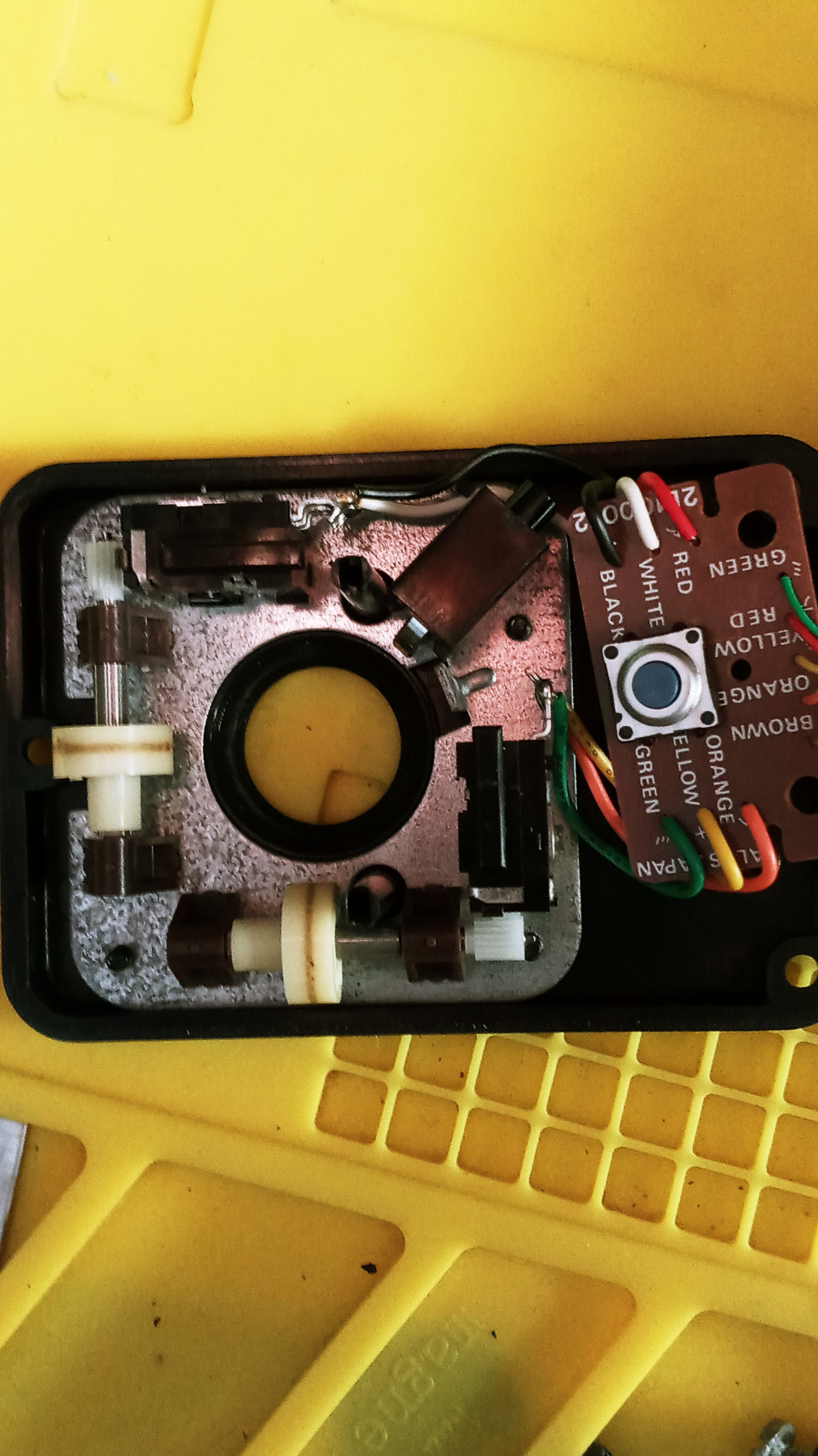

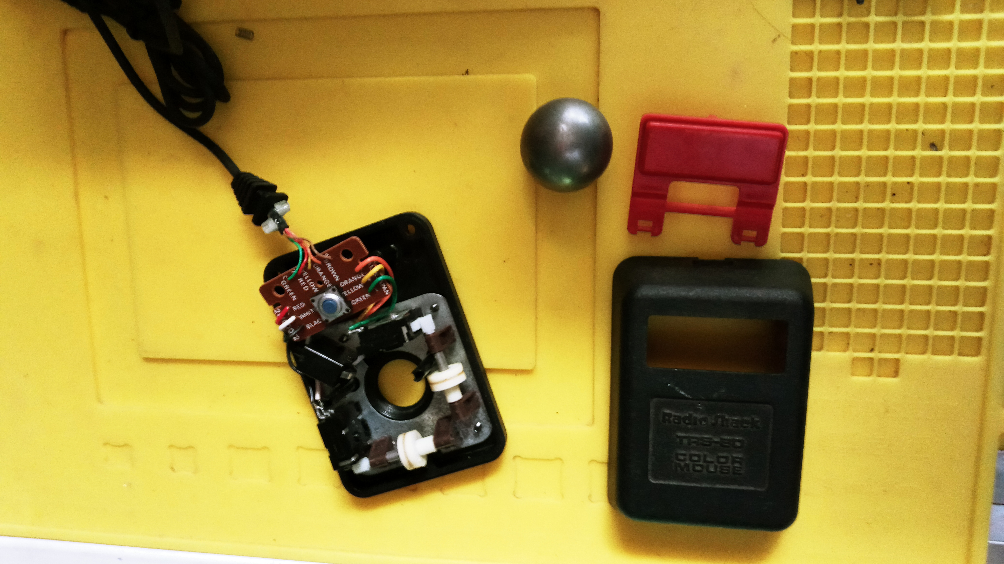

    So I doubt I'm going to bother with the mouse anyway, until I get the 800 running again. really, it would be stupid to do it now since I can't test it right away before I put the mouse back together, or I may be taking it apart and redoing the hack if I hook things up wrong. One main thing is making sure the mouse's pot lines match up with the Atari Touch tablet as to which pots are controlling X and Y coordinates or things could end up backwards.
    You'd think this would be a no-brainer, but there was no standard between computer brands as to which pots (assuming a POT0 and POT1 or 1 and 2 depending on how they chose to number them) controlled X or Y movement. In fact, even on the Atari the Atari touch tablet is the opposite of the Koala Pad and the Super Sketch drawing board. So you can't use one tablet with the other's software unless you splice and cross the pot lines at minimum, which I think is all that is different between the Atari touch tablet and the Super Sketch pad. But the Koala vs Atari is different.
    There could also be an issue with the software too, in whether the programmers decided the 0 "starting" position should be for each pot and if moving to the right is counting up from 0 or down from, IIRC on the Atari, 255, and the same with the other direction.which is actually the problem with the Atari tablet vs Koala, as the X direction and Y use the same pots, but the program's Y movement position count is opposite on the Koala and Koala Paint than it is for the Atari Touch tablet and Atari Artist.
    So I need to test the mouse with the 800 for which pots go to which pot line as well as if Atari Artist's cursor will move up the screen when I push the mouse forward, or if it will move the cursor down and the same thing with the other direction. I might be able to fix this problem on the pots in the mouse, if they exist, by swapping wires on the pot itself so that the pot reads opposite input possibly, but that may not work. But the chance is good that if the mouse isn't compatible with programs that use the Atari Touch tablet, that it is compatible with ones that use the Koala pad. And some, like Rambrandt, let you choose either tablet. Then I'll just use the programs made for either-or and the ones that work for both.
