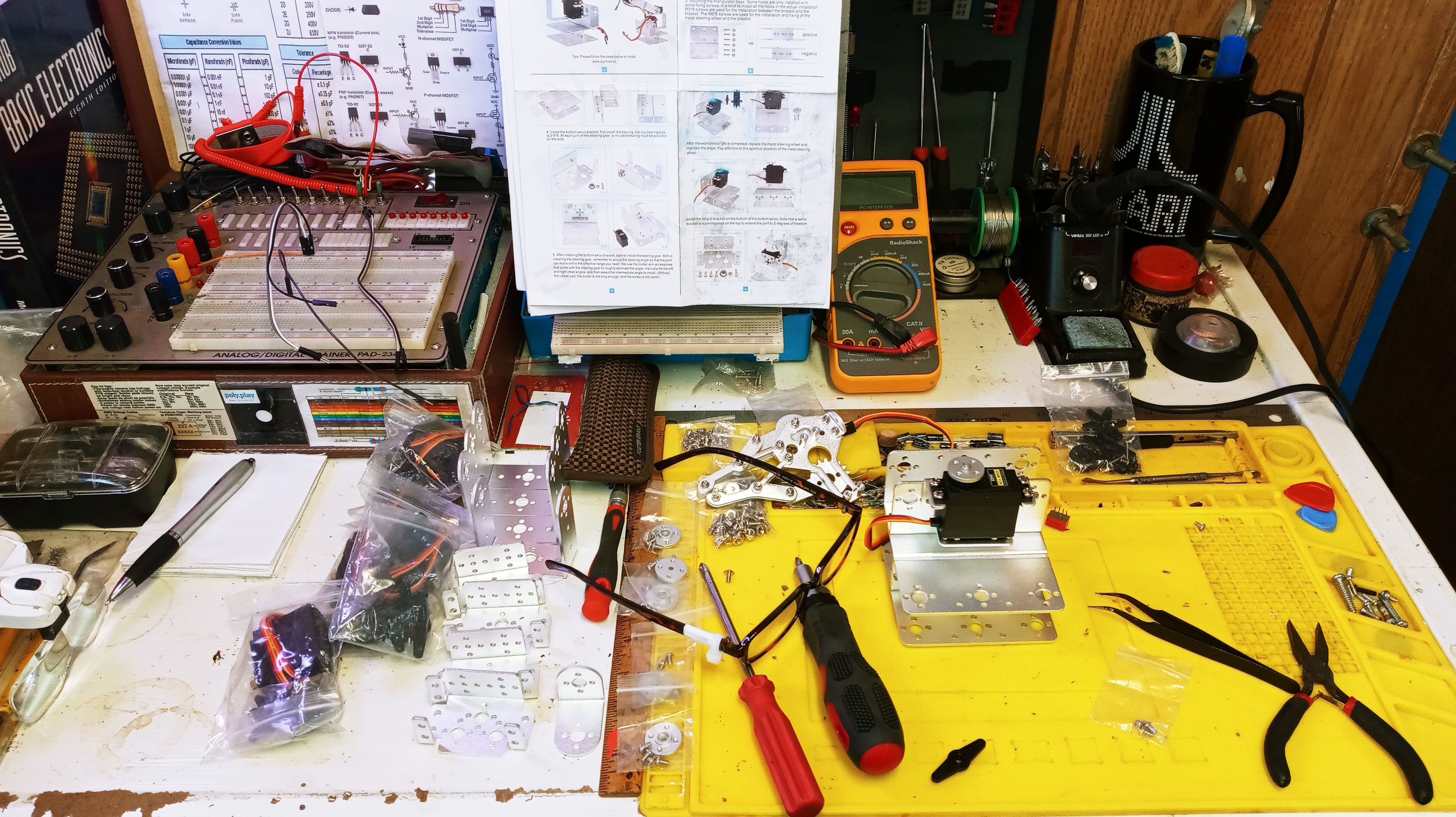

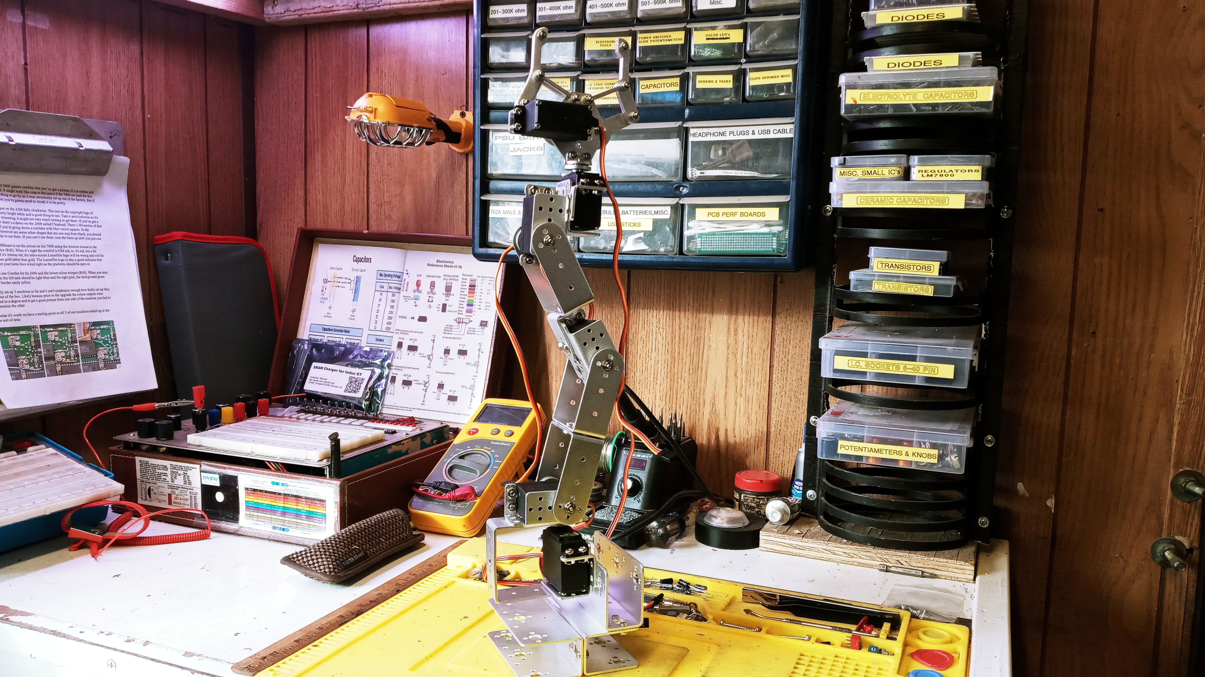

    The robot arm is fully assembled. Now it is time to get a data sheet on the servo motors just to know what the three wires coming out of each one is used for, then start making wire harnesses going from the servo wire connectors to RCA plugs at the other end ready to plug into the RCA jacks on my AtariLab Interfaces.
    From there, it will be all about programming, both autonomous pre-programmed movement and and interface program to control the robot arm manually with joysticks, it will probably require two joysticks to allow for all the movement controls in six degrees of freedom. This is were my two modified Starmaster joysticks will most likely be used (one borrowed from the 7800) as they have the suction cups to hold them in place so I can operate both sticks at the same time, and I believe the yoke-like grips will make it much more comfortable than standard CX40 straight sticks.
    Not only are the manual controls for me to have a bit of fun with, but if I get good and proficient with them then instead of just typing in movement coordinates, a program will allow me to manually move the robot arm and record those inputs to be used in programs speeding up programming and less math and geometry to worry about calculating.
    Now that it is assembled and I have a better idea on different ways the arm can be mounted to a chassis or body, I think that one of these arms mounted on either side of the robot chassis/body will work well for manipulating and holding onto objects, and I probably won't try to use an arm with a five-fingered hand, as that just complicates things for me, and the 8-bit Atari that will be running the robot. It will leave both I/O more free for other things, and far less complicated processing for the 6502 to require for manipulating things. Besides, it's going to be more like a Star Wars "Droid" type robot (like R2-D2, not C3-PO) and not a humanoid style biped or an android.
    Six servo motors on the arm to enable the six degrees of movement and claw manipulation.
    The thread will continue, though it may be a few weeks before another update as I still have some work to do on my 800CX before I can get started using the arm with it.
