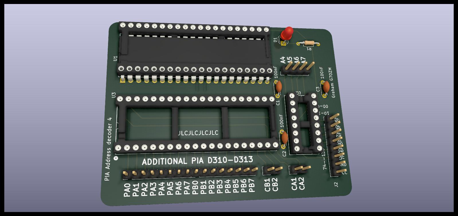

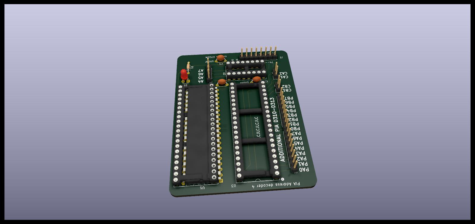

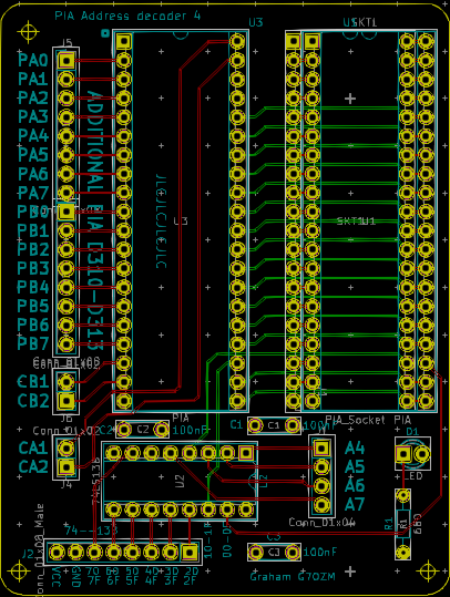

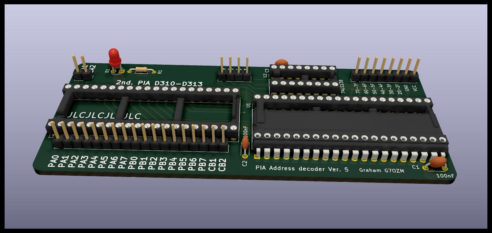

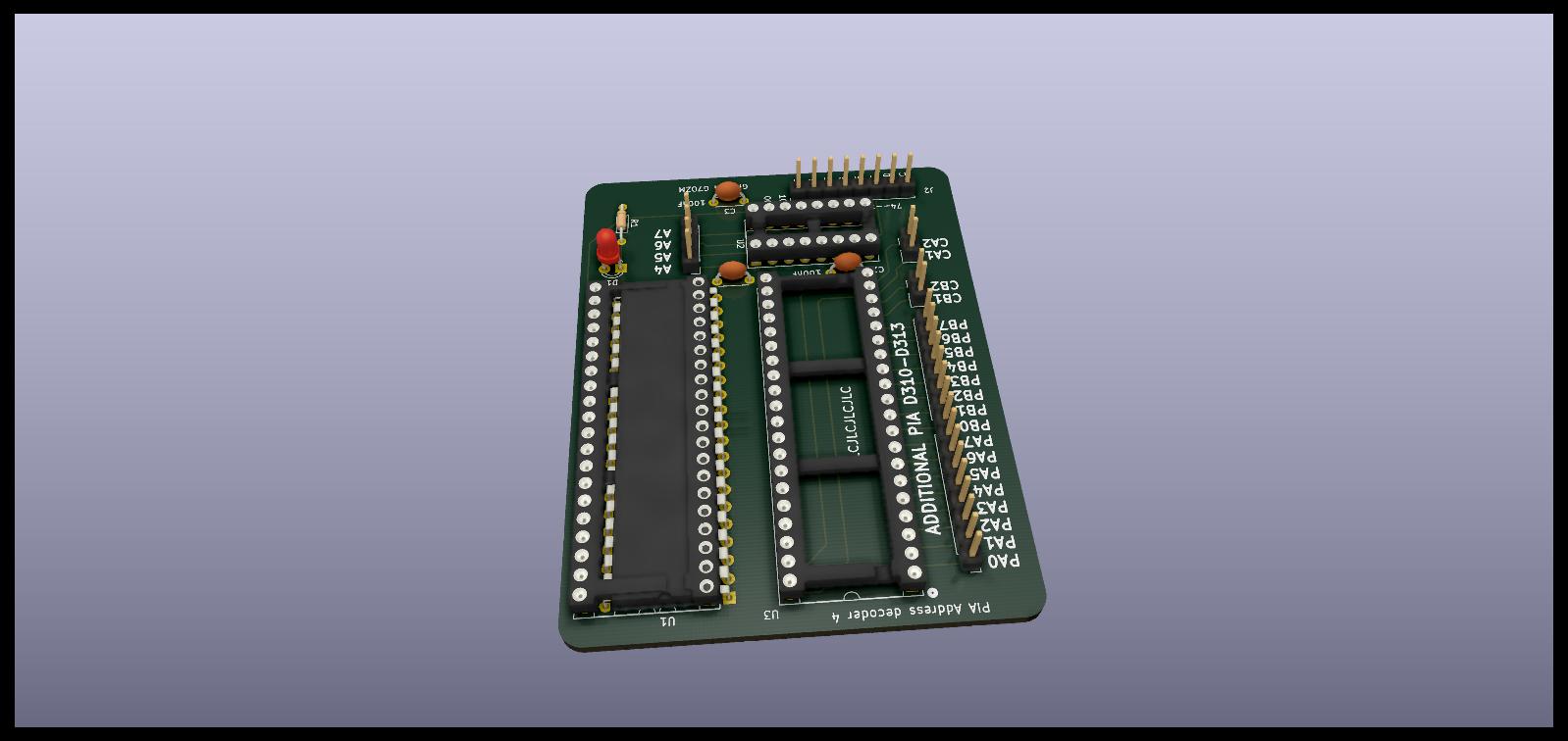

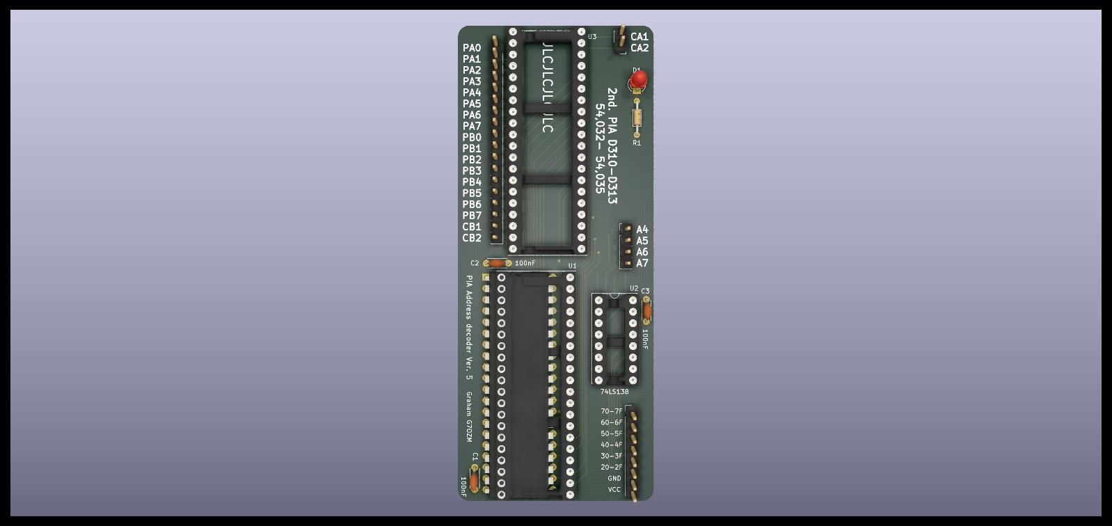

    No I use JLCPCB , so you can buy batches of 5 or more, my original designs (were upto ver 5,) allowed fitting with various issues and trying to get to fit within 100mm x 100mm , I designed one with the two PIA's end on so like a strip, ended up 108mm x 43mm, so the area was o.k but exceeded 100mm so was being charged a lot more. I'm also taken to using 4 layer boards with the two inner layers as Power, it make it so much easier to degign, without adding a hugh amount to the cost.
    So cost went from $5.90 for 5 to a fraction under $30 for the same amount, see attachments for some idea ..
    Version 4
    PIA_Address Decoder_4_a.jpg PIA_Address Decoder_4_b.jpg PIA_Address Decoder_4_c.jpg ver 4.png

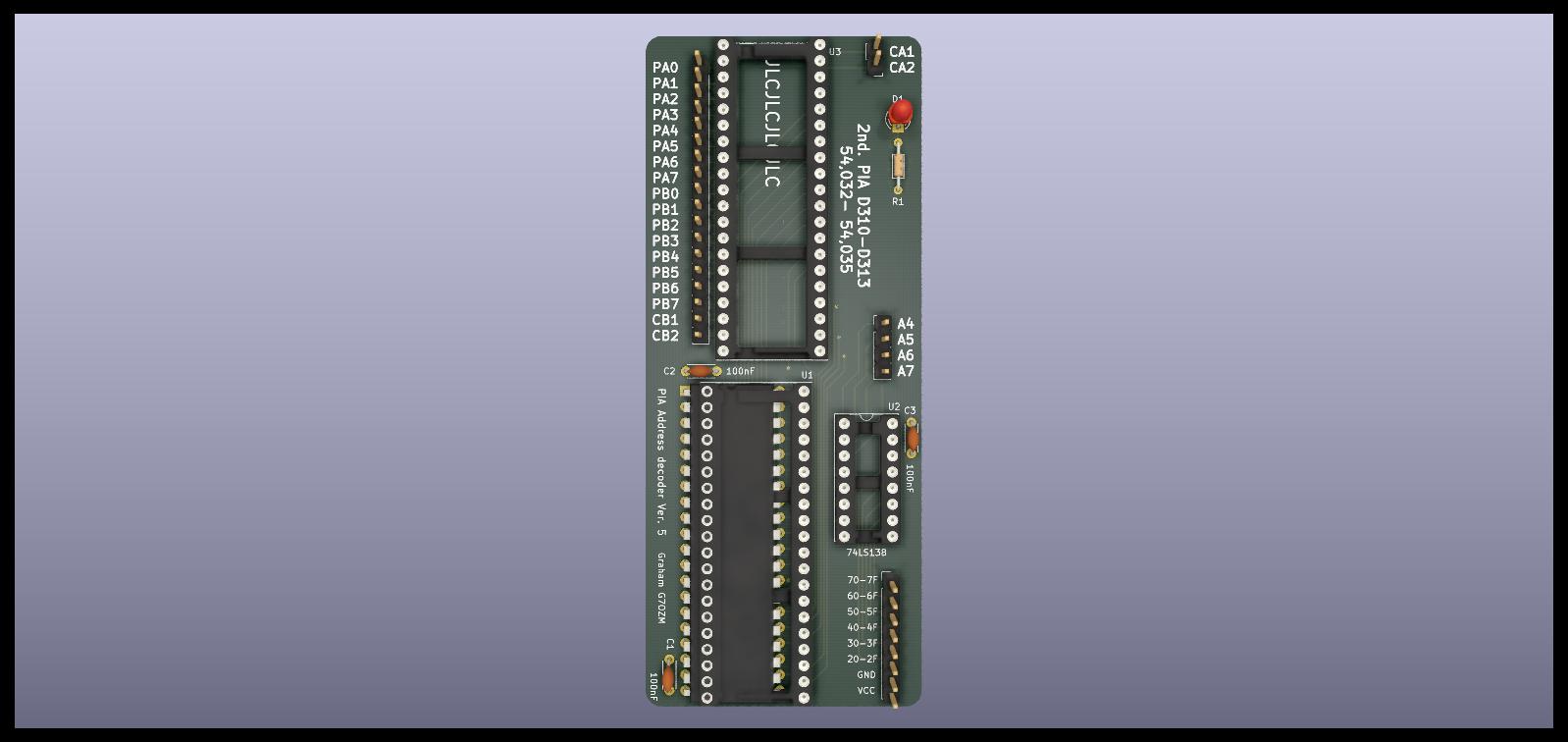

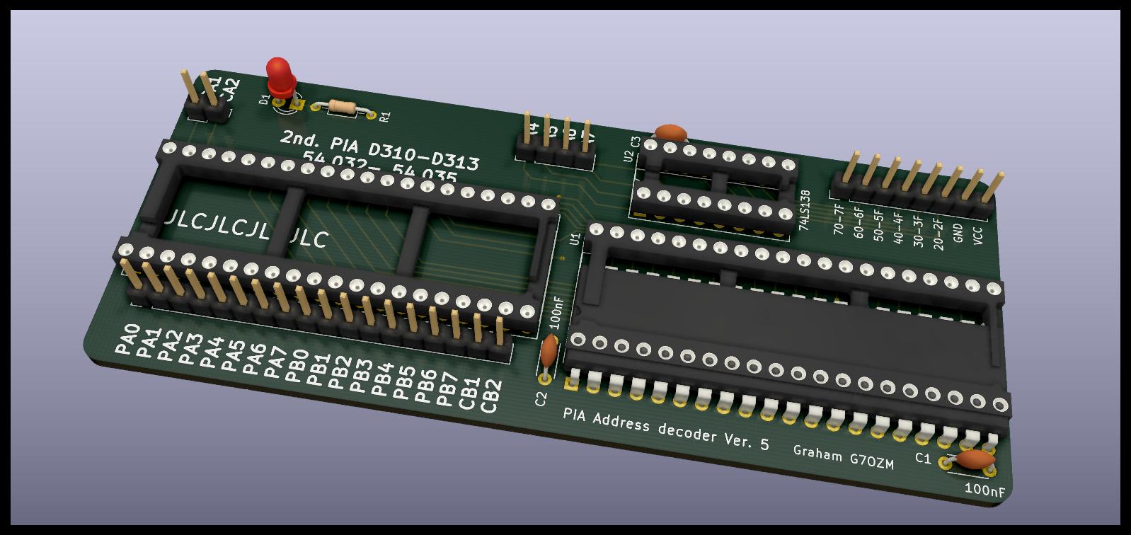

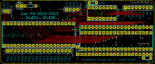

    Version 5
    PIA_Address Decoder_5_a.jpg PIA_Address Decoder_5_b.jpg PIA_Address Decoder_5_c.jpg ver 5.png

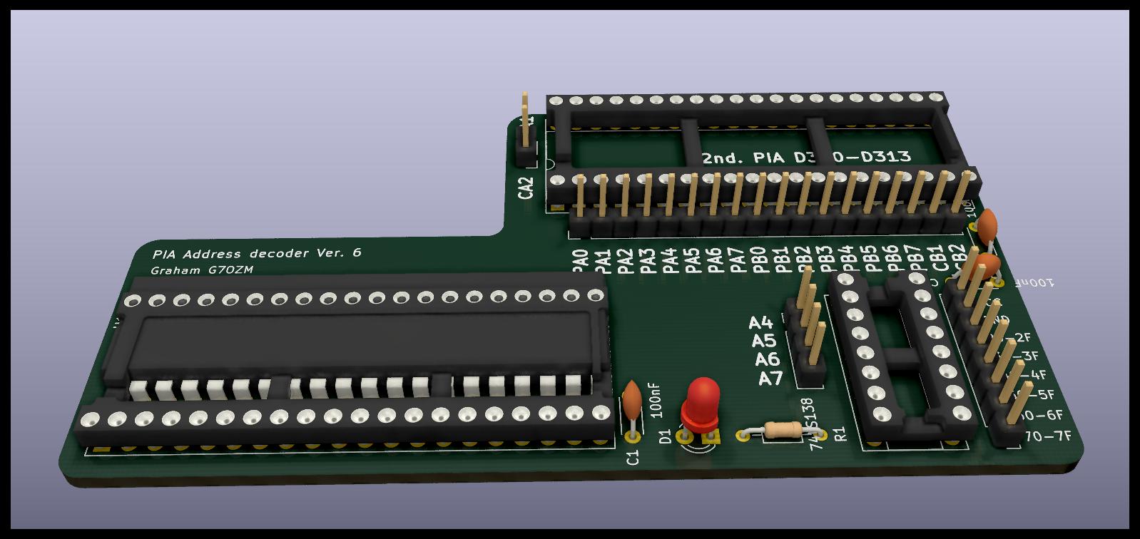

    Coming a verion 6 '

    The cost for a 4 layer board x 5 i.e. design 4 but 5 of them was £5.90
    the cost for a 4 layer design 5, again for 5 of them was £26.25

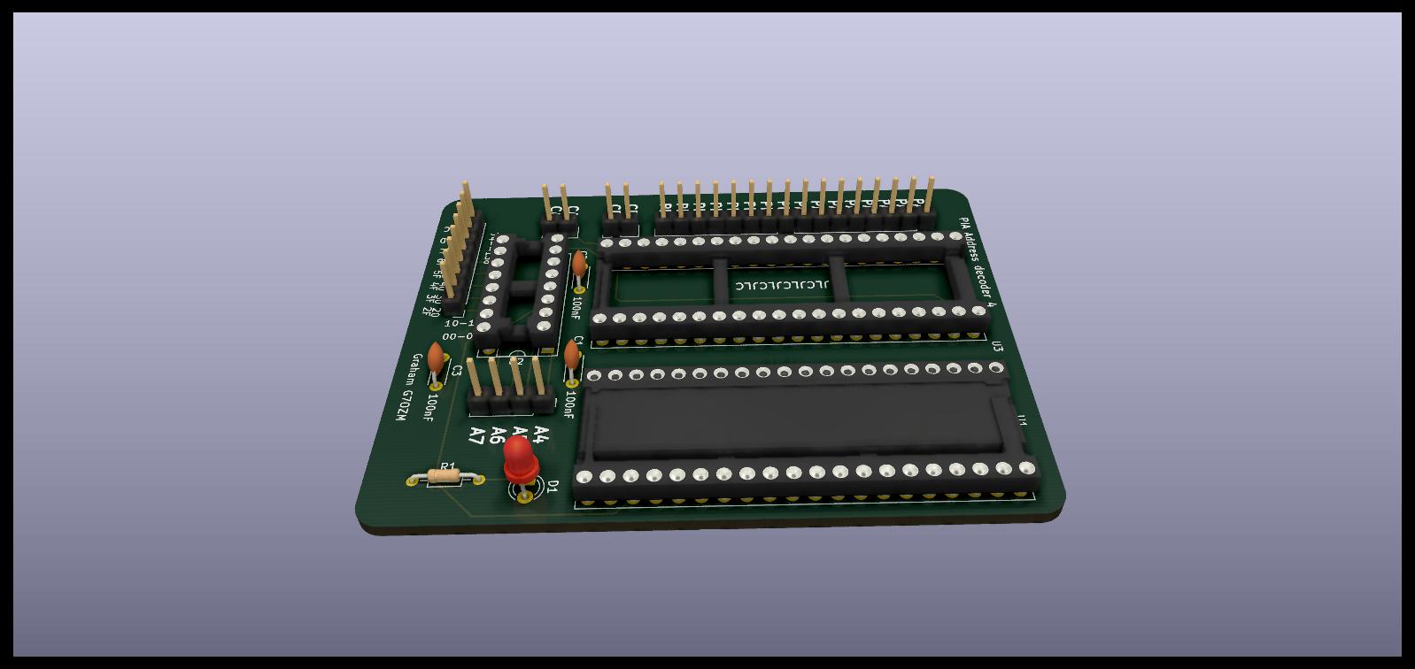

    What I intend to do is to have acombination of both boards, the board will plug into the original PIA socket as previous designs, however the additional PIA will be ofset towards the right as you look at the 800 main board, but also slightly behind so the the total width will be back down to less than 100mm and the depth towards the Pokey used, but leave most of it on show and not covered in any way by the new board., looking from the Righthand side i.e. Power board towards you, then the board shap will be like a capital letter 'L' .
    Hmm Try drawing and attaching ..

    Like this
    Matt the cost is for the circuit boards only, although it won't show, there are male to male turned pin 'plugs', that plug into the original socket and are solder ofset under the original PIA , why it looks a bit funny with a socket and a Chip on top of each other.
    The other components are 3 x 100nF cap's and a 74LS138 ,or HCT or F type.
    I added an LED to warn peeps if the machine was turned on, whilst attaching anything to the additional PIA, likely it wouldn't like this :facepalm:
