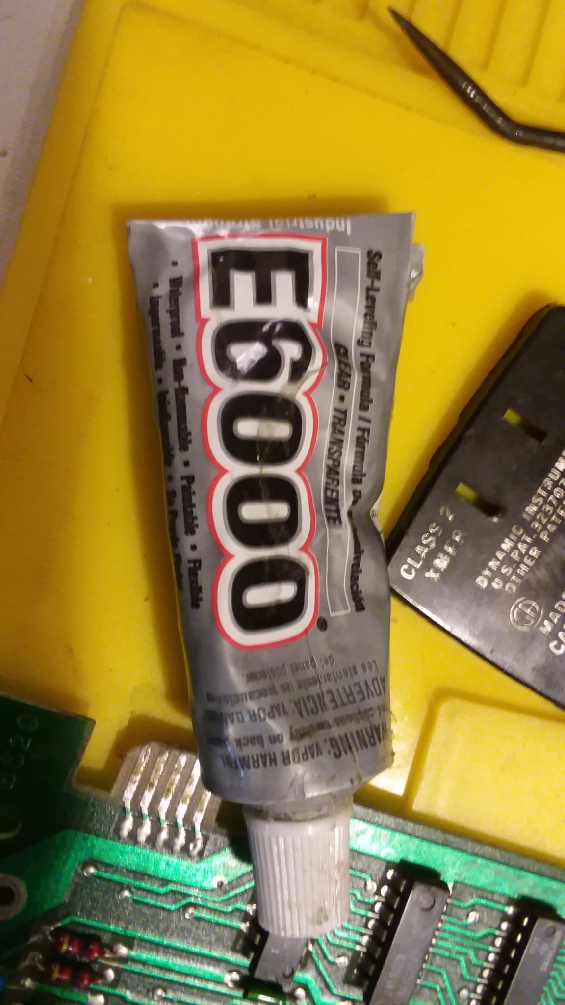

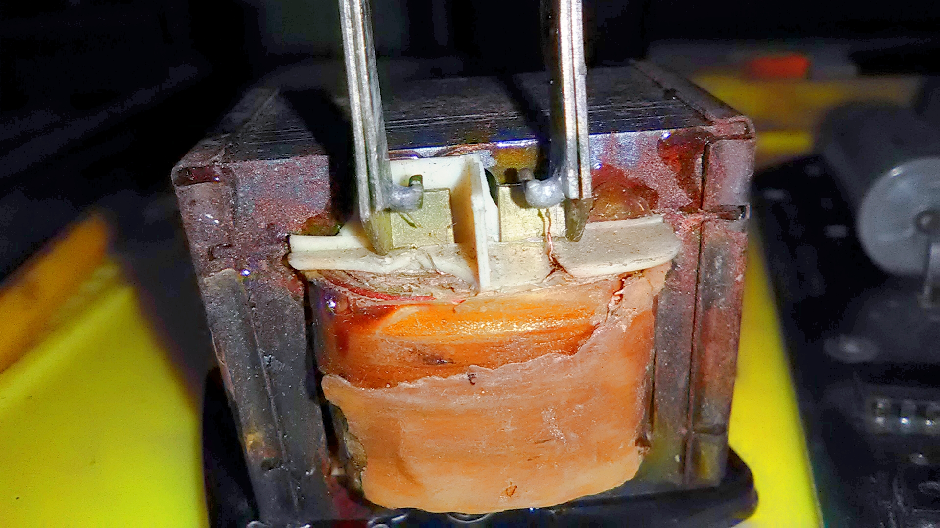

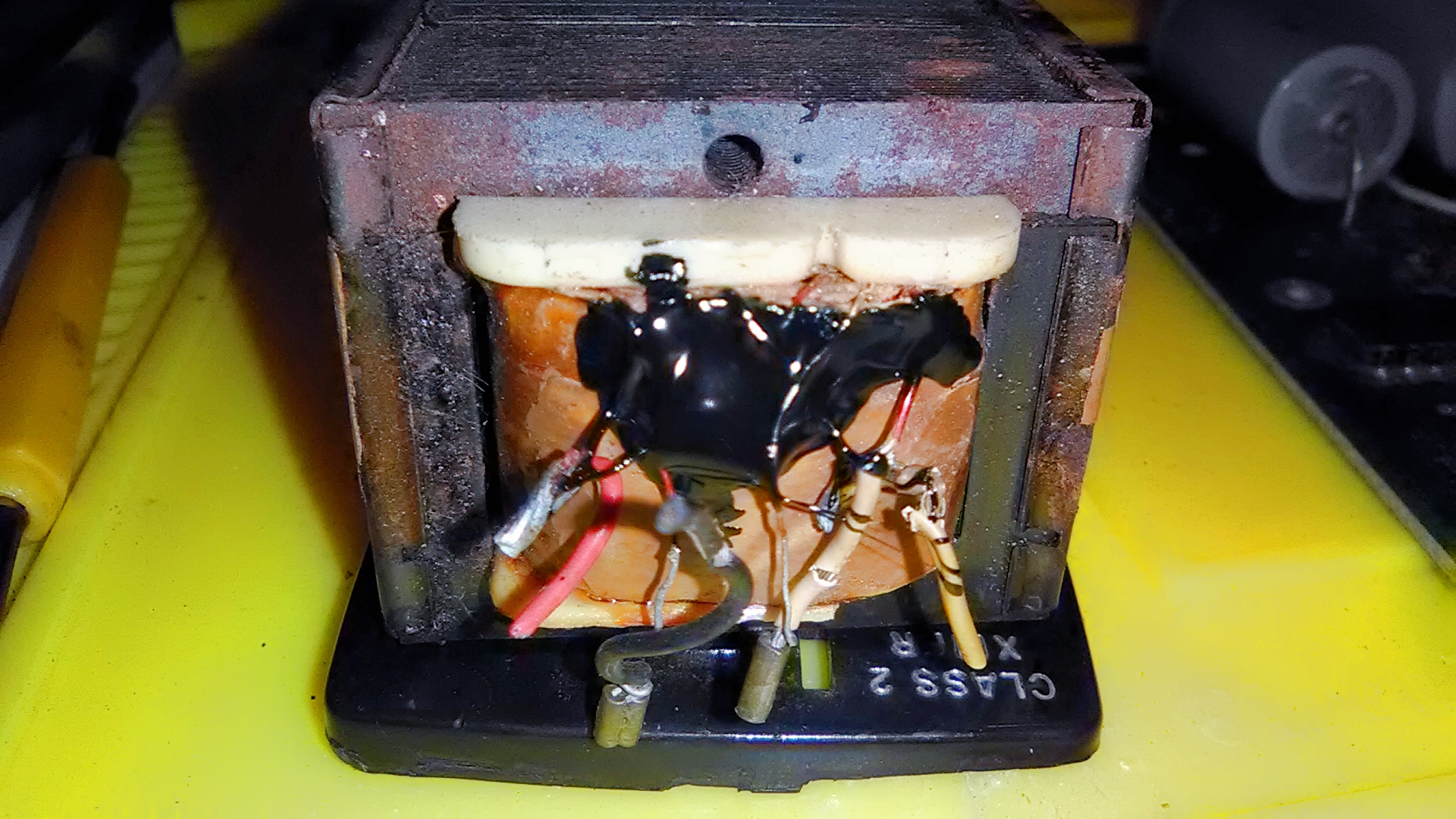

    I've also been looking over the original PSU, and I think I may be able to repair it. I'll have to salvage a cord from somewhere else though, if my repair works. A cord with 3 lines and ground, between the wall-wort PSU's output wires and the Bally Arcade's power input terminal.
    See the broken wire in between the left hand prong and the transformer?
    I am currently separating the output wires from each other and insulating them a layer at a time with Liquid Electric Tape, allowing each layer to dry. These wires were originally supposed to be held in place by insulating tape between the wires that wrapped around the transformer. This tape was long removed, I don't recall if by me, years ago, looking for a broken wire/connection or before I owned it. I'll also secure the wiring back to the transformer with tape again, or zip-ties, and the cord I am connecting those wires too as well, so these delicate wires are not broken off from the transformer by pull-stress..
    Though the outer housing of this PSU transformer is rusty, which I will clean off, I believe the coil inside to be in good condition still, under the insulating tape, and if so, the PSU should work again once I repair the broken power input wire on the plug.
    Once I repair the wire, and if the PSU is working, then I will use some industrial strength E6000 adhesive to encase the plug-to-transformer wires, which will become a hard, clear, acrylic blob to avoid them from breaking again, probably from stress when plugging and unplugging it from the wall. This is the stuff I finally used to permanently attach the PBI edge connector on my 1200XL to the motherboard, and it's worked flawlessly under the stress of repeated plugging and unplugging the Syscheck board now for a year or two. Like another favorite of mine, J.B Weld, I can't recommend E6000 enough, when it absolutely positively needs to stay put!
