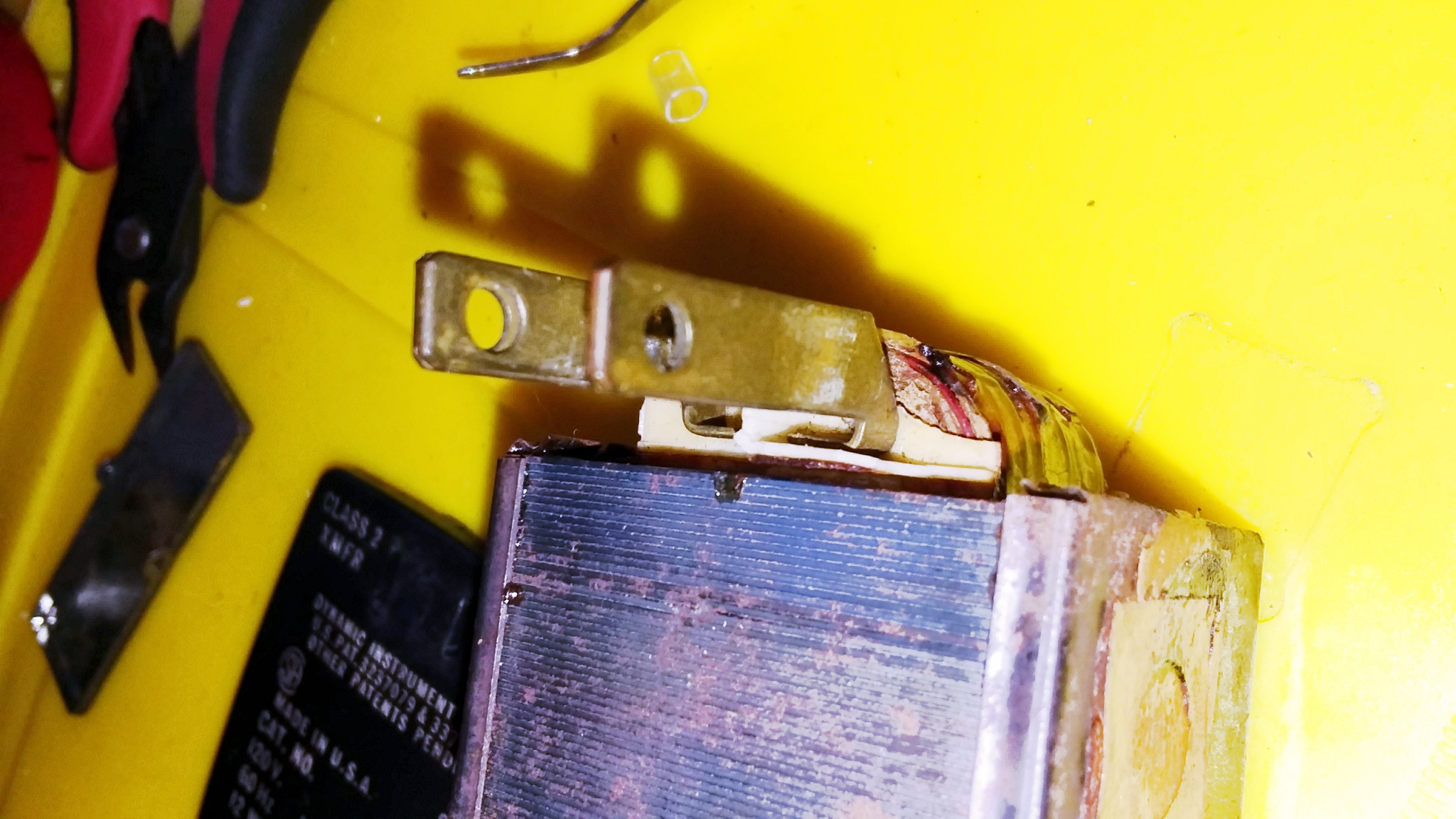

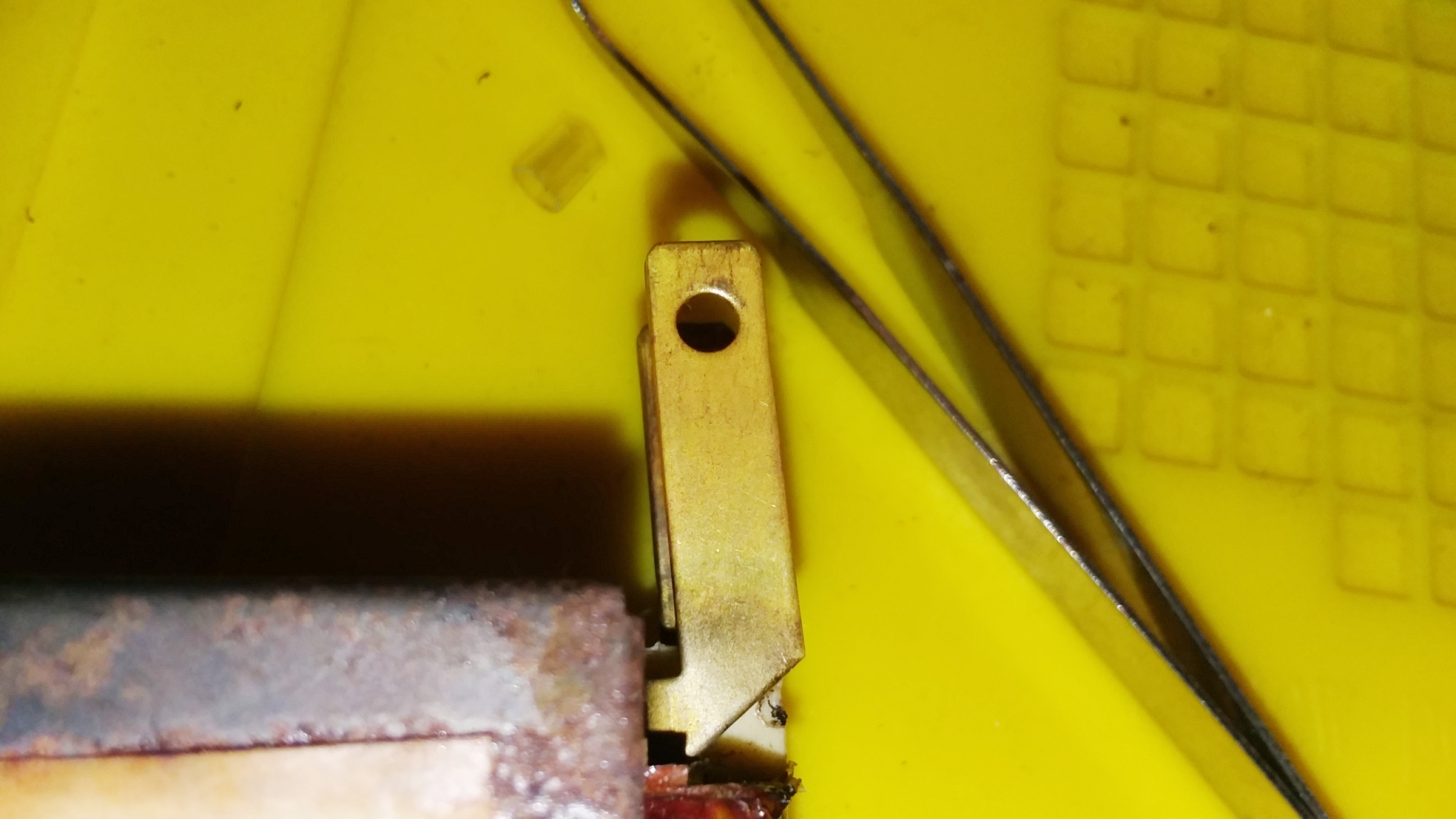

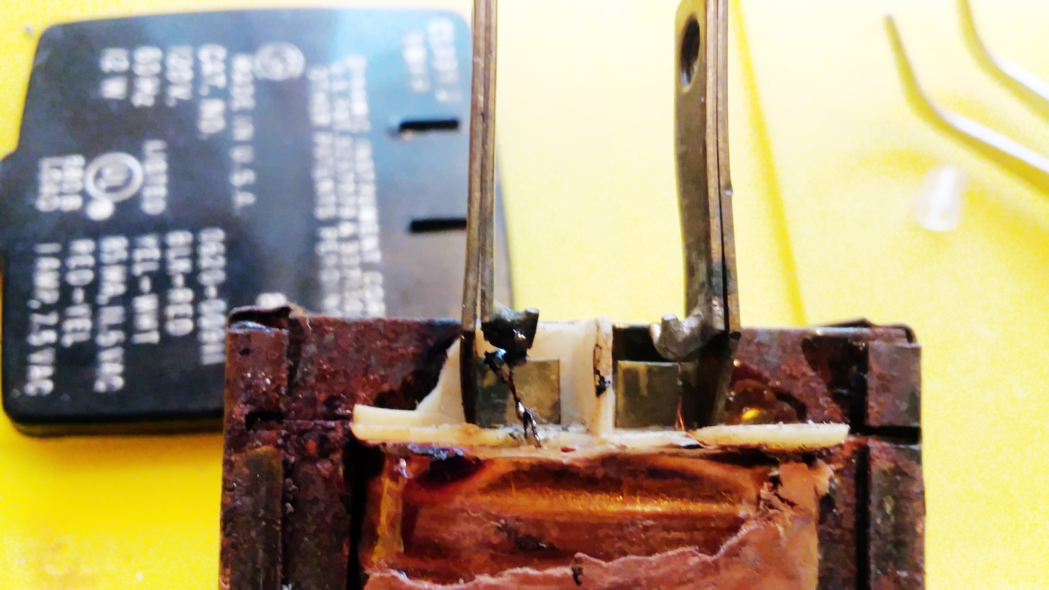

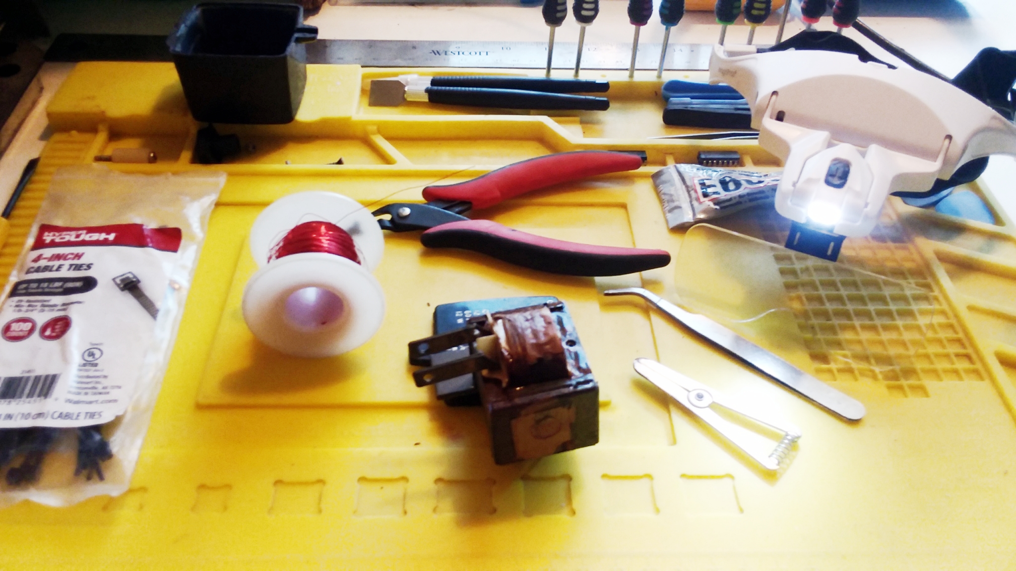

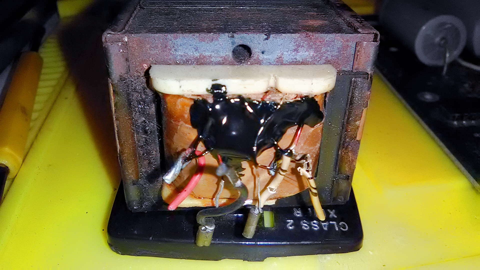

    So, back to my attempt to resurrect the OEM PSU. A delicate wire repair needs delicate wire and precision tools to accomplish:
    Here is the PSU after it is repaired:
    Here are all the output wires, isolated and insulated with Liquid Electric Tape.
    Before I start connecting a cable, I'll still need to secure it to the transformer too, with some Zip ties, but the next step will be plugging the PSU into an extension cord and testing the output wires for voltage, and proper voltage, or there's no sense in continuing and my attention will have to turn to making a new PSU with two transformers that fit the voltage and minimum amp specs.
    But first, one more thing to ensure a good connection with the outlet, I'll be cleaning off the heavily tarnished plug prongs with TarnX. just dampen a paper towel with the TarnX and rub down the prongs/posts. I'll also use TarnX on the motherboard edge connectors when my attention returns to it. Your focus is your reality.;)
    A before TarnX shot:
    An after TarnX shot:
    So, now off to test with the multi-meter, I'll show pics of the results in the next post.

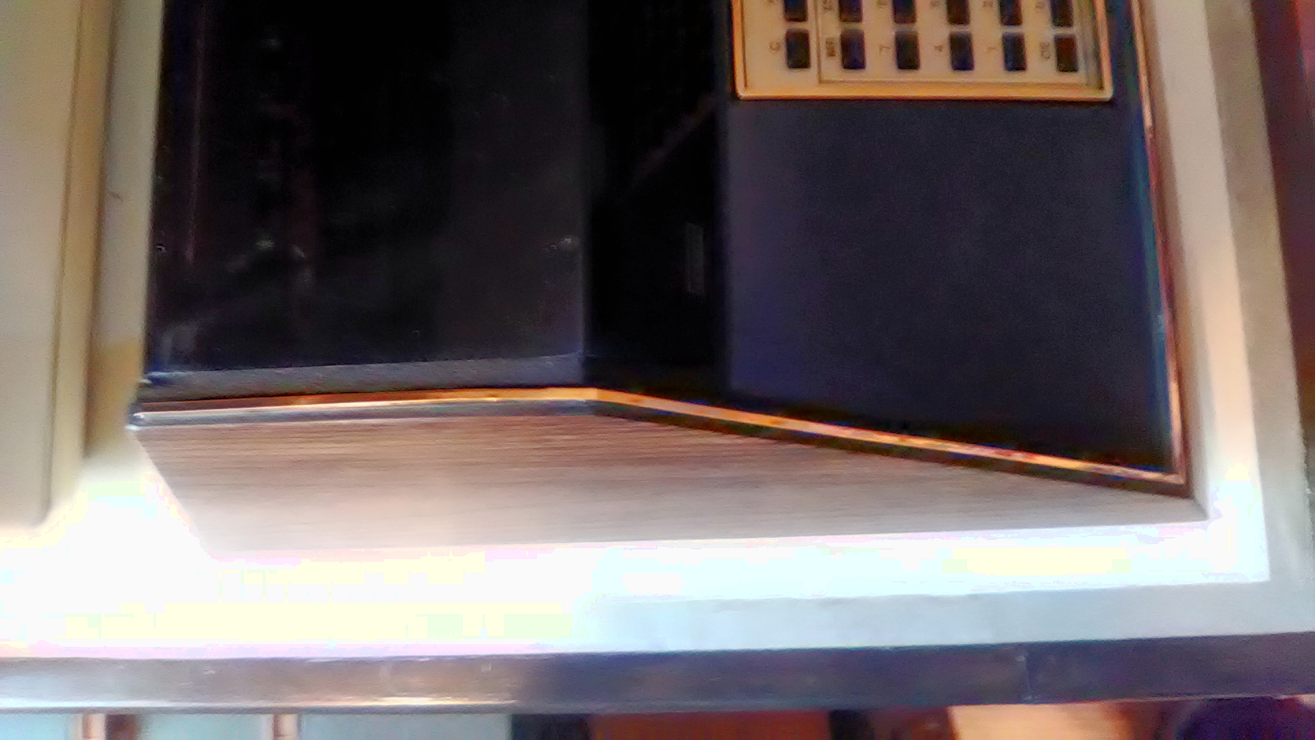

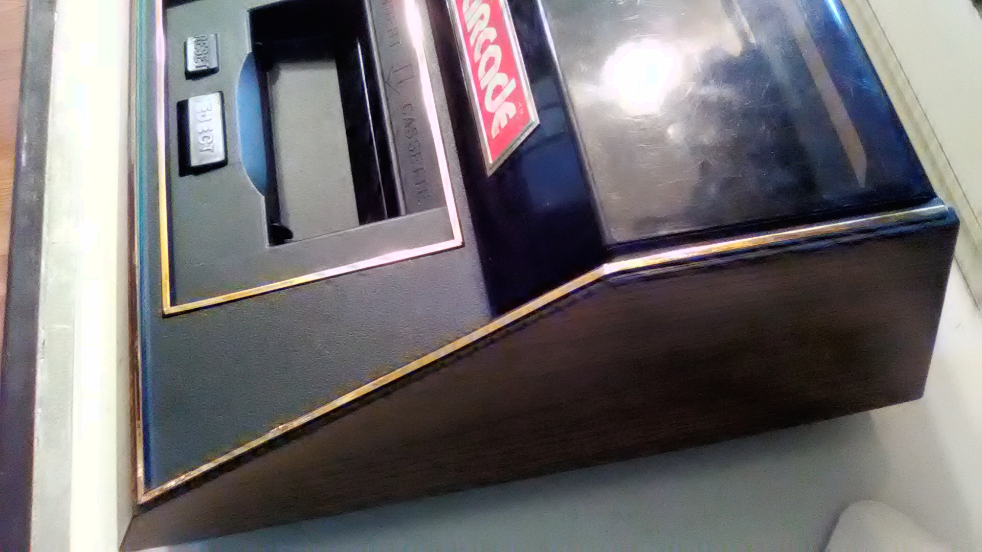

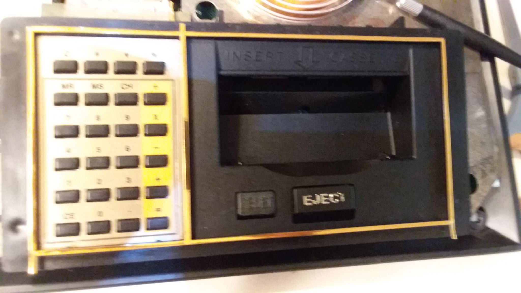

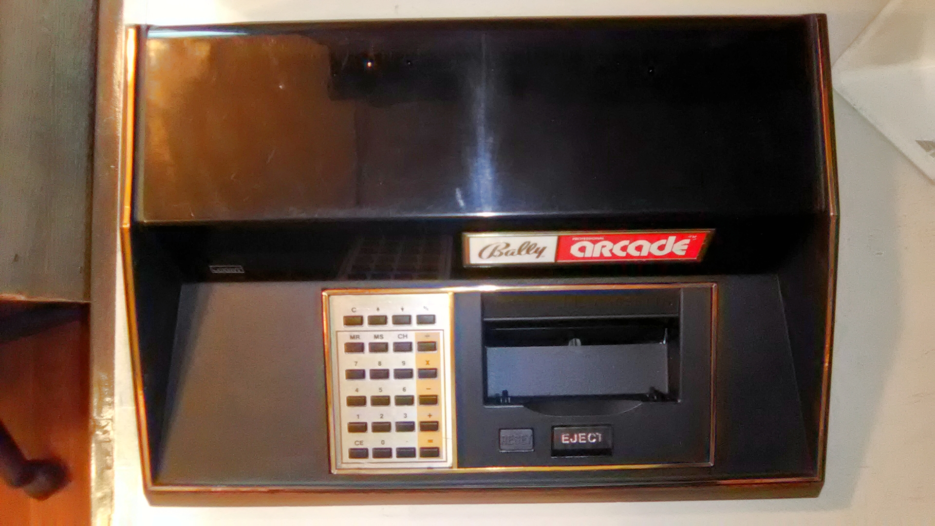

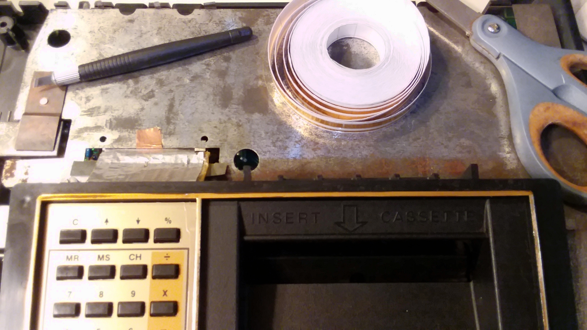

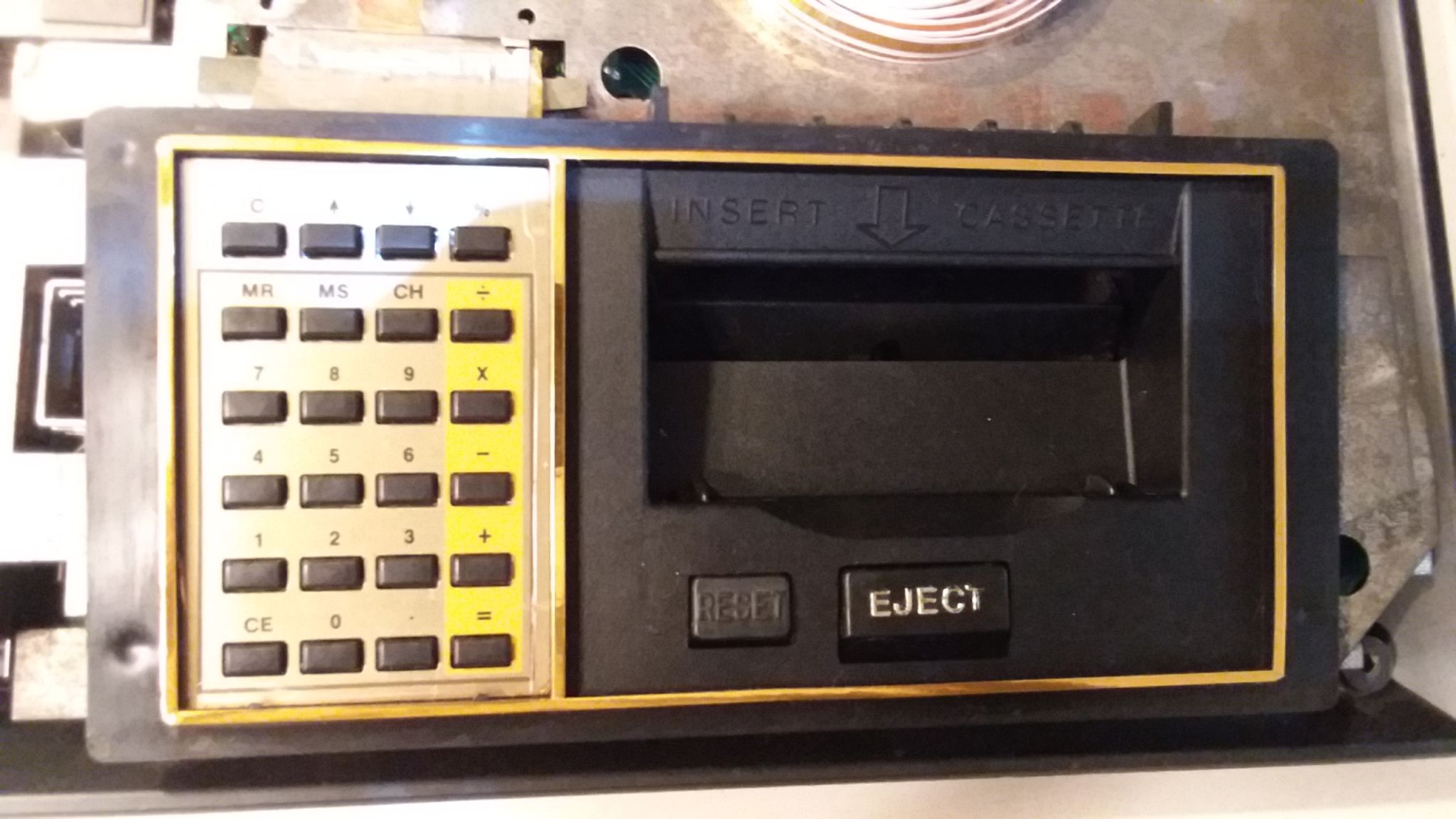

    Alright you 8-bit retronauts, here are pictures of restoring the gold chrome trim around the keypad!
    Here is the first strip in place at the top.
    Here are top and bottom strips in place, the bottom plastic protective coating half-way removed for show.
    Here we have all four sides and the center keyboard trim in place, over-lapping prior to trimming.
    Here is the final result, after over-lapping the trim, cutting at a 45 degree angle on the corners trims both top and bottom strips to be flush. The center trim separating the keypad from the cart port was cut straight across using the upper and lower trim edge as a guide to cut as close as possible to be flush and hide the seam as best possible there too. And finally, the corners of the trim are trimmed to match the outer curved corners of the keypad and cart port frame.
    Here is what it looks like with the case back in place over the keypad.
    I'll post pictures of the outer top-case trim restoration tomorrow.
    Klyde and Andy Barr like this.

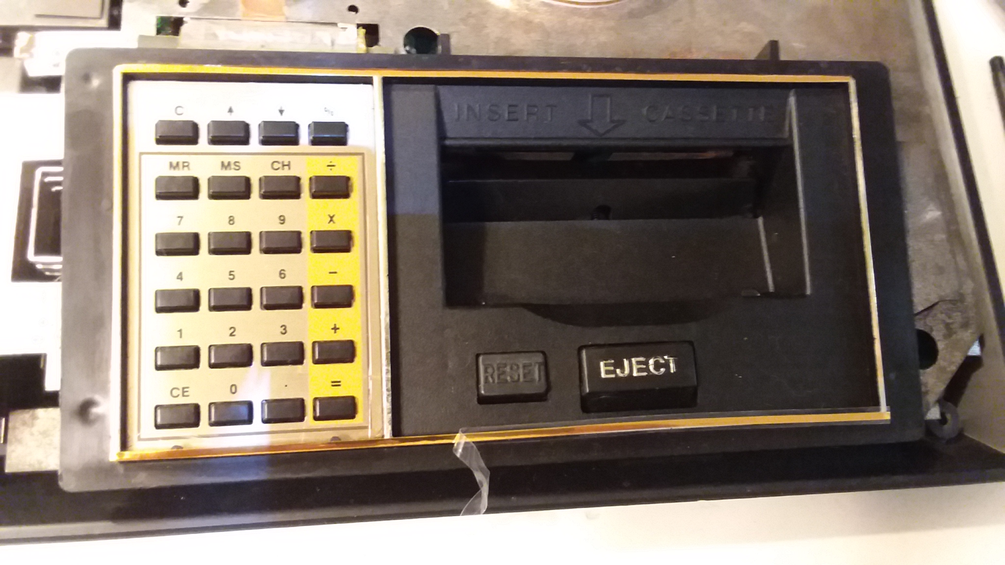

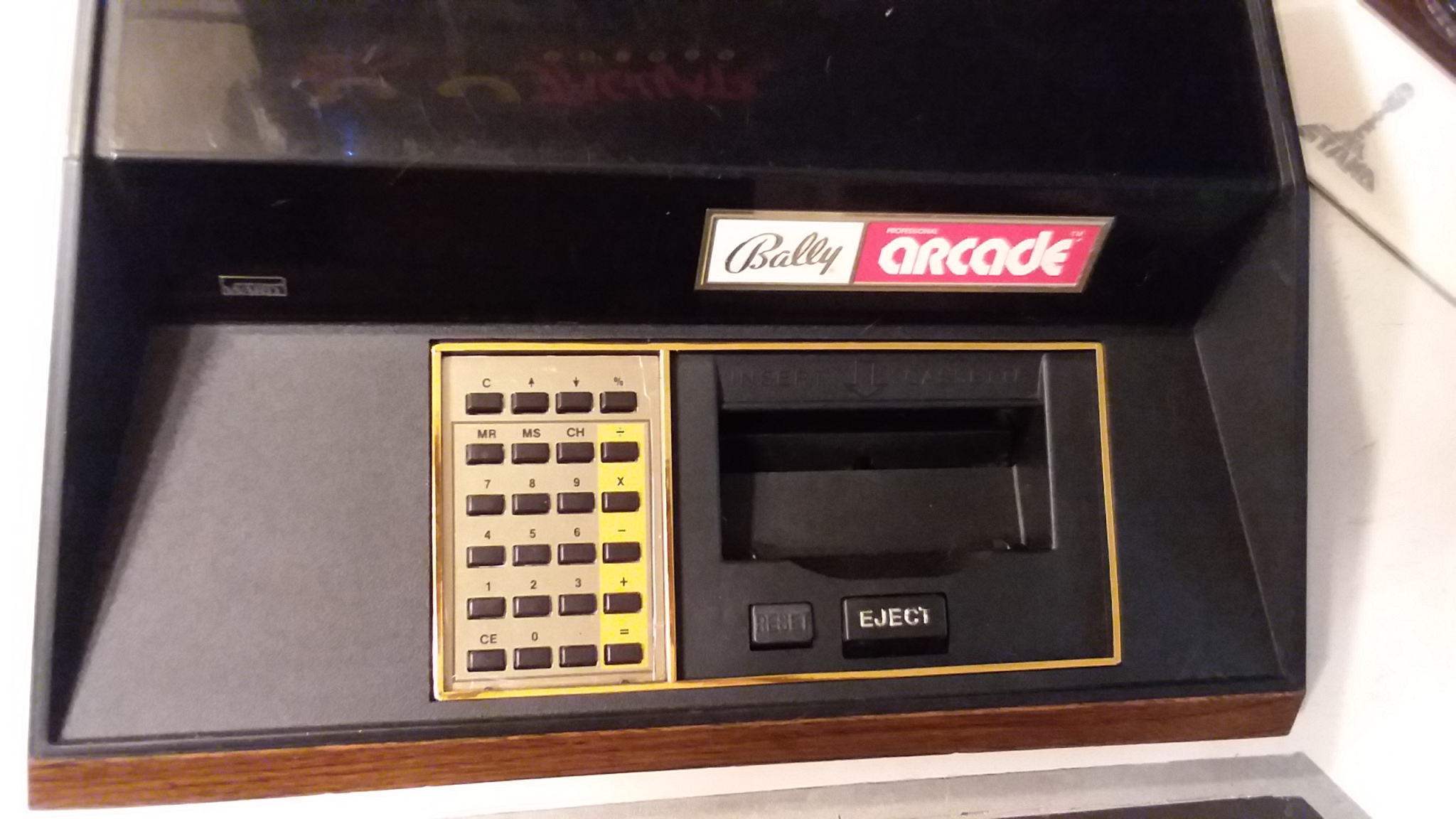

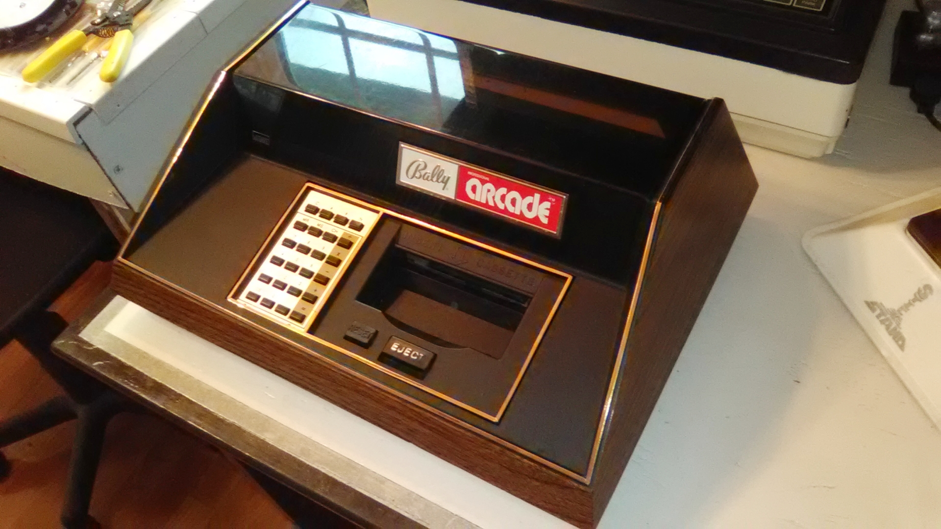

    Here is the finished gold chrome trim on my case. All that's left is painting the RESET and EJECT button's raised lettering and some Wipe-New on the tinted clear cover for original luster, and Ms. Bally will be restored to her former beauty! (cosmetically anyway)
    I wish they were better pictures, but I have terrible lighting for photographing in this room and the flash only adds glare. The last picture is an attempt to get a shot from the same angle as the picture I posted 2 posts above.

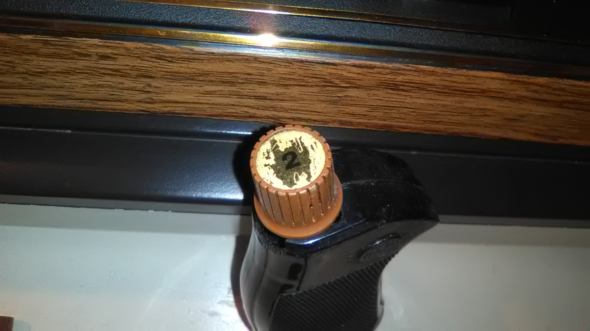

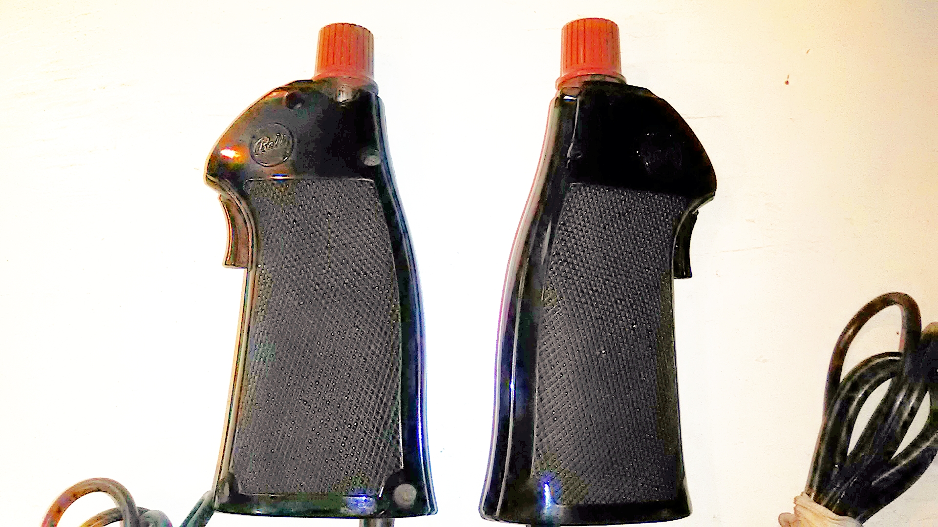

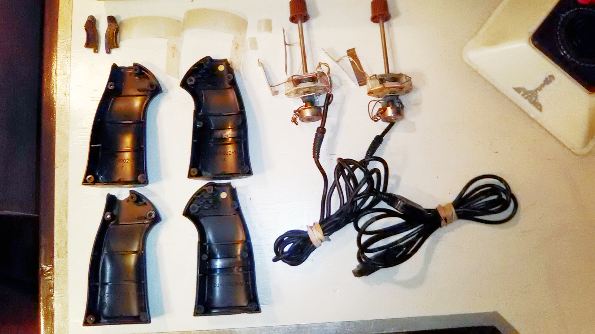

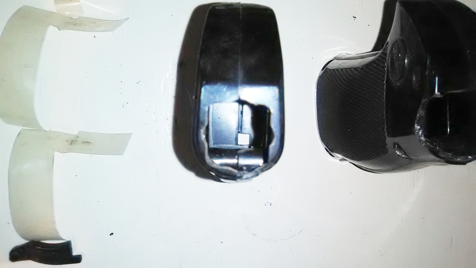

    So, before I get started, here are some "before" shots of the controllers and current condition.
    In the last picture showing the top of the controller, I believe that is corrosion on the gold metal surrounding the "2." I'm hoping I can clean that up some or completely with some TarnX. The number one controller is in much better condition with no corrosion, only a few fine scratches that will stay, to give it "character" and I'll shine both up as much as possible too.
    The Bally logos on both sides used to have gold chrome plating on them, and will be painted gold after the controllers are repaired and painted black.
    One controller is broken in two places, the other in one.
    As stated before, I will be using the same technique on repairing the broken parts as I did with my Syscheck XL case I modified from a Commodore modem case (as seen on AS). using electrical tape for the mold around the outside, and fill it in from the inside with J.B. Weld. Then I will use copper trace repair across the top with more J.B. Weld on top of that to create extra strength. Sort of like re-bar in cement.
    IMG_20200223_145845.jpg IMG_20200223_145239.jpg IMG_20200223_145233.jpg IMG_20200223_145229.jpg IMG_20200223_145330.jpg

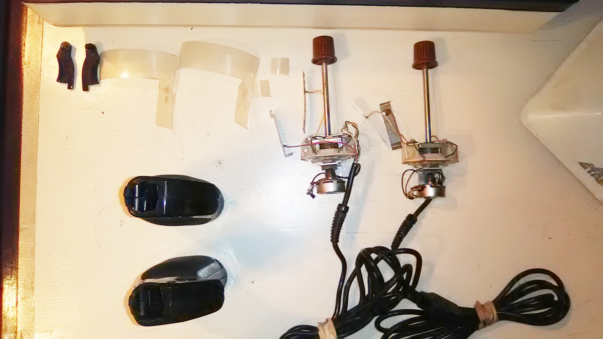

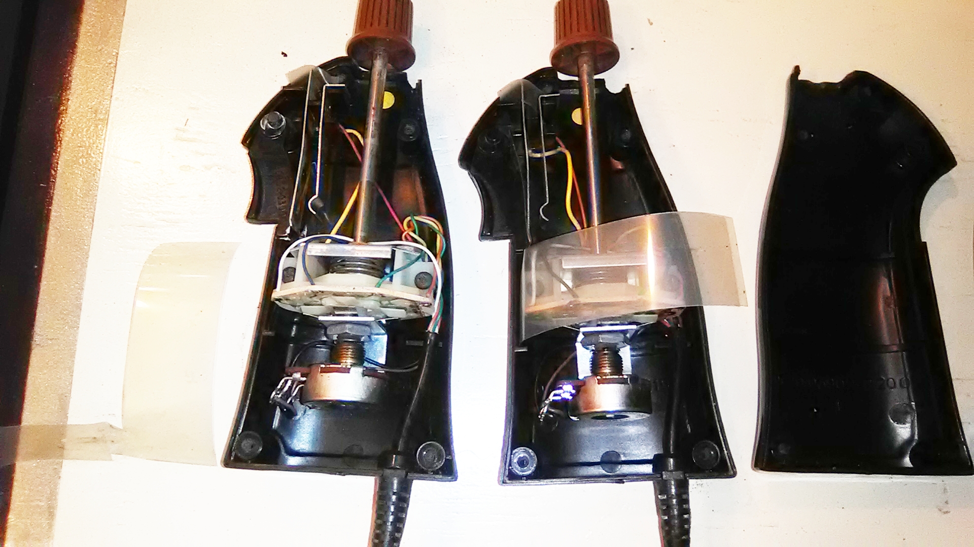

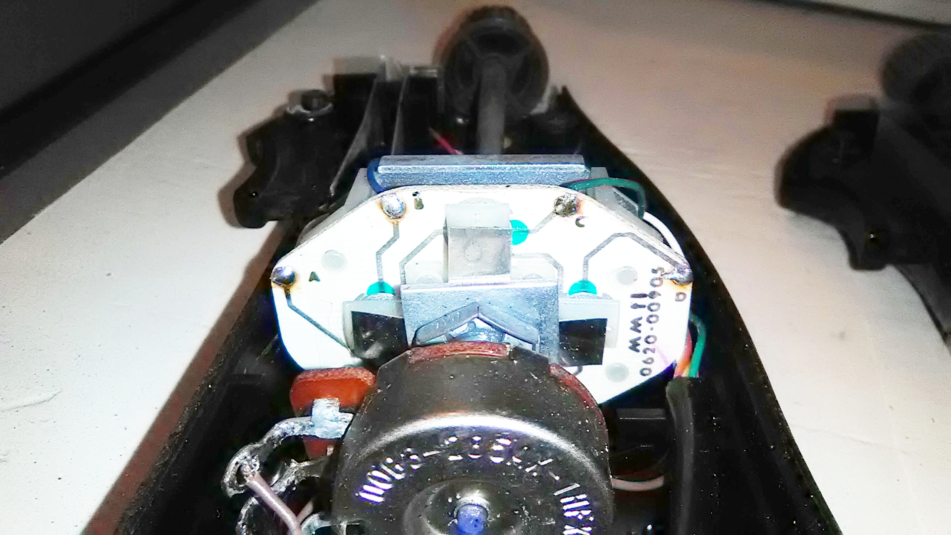

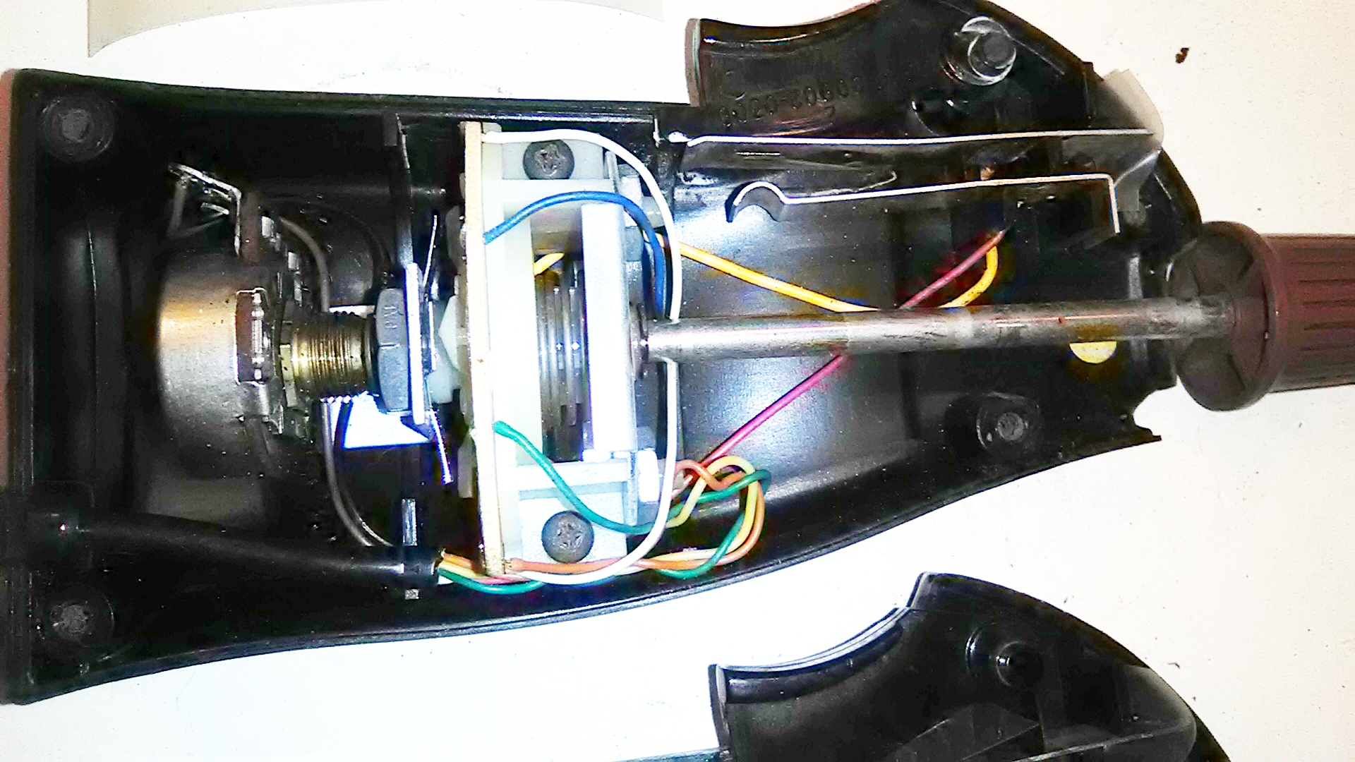

    Here are interior shots of the Bally controllers, for the curious.
    One has a plastic cover in place and the other has it removed, that cover slides between the trigger and the leaf switch and wraps half-way around the joystick apparatus. It has a heavy-duty spring which returns the joystick rod to center. On the bottom of the mechanism is a small PCB board which, once again, contains metal bubble contacts like those found in Atari CX-40 joysticks. But, there are heavy-duty leaf springs attached to the rod that press against a polyurethane "wings" that actually press against the bubble contacts in this chain reaction. Underneath all of that is a pot that looks pretty similar to the ones found in Atari paddles.
    It's all almost arcade quality, which one might expect from Bally/Midway, since they had/have an arcade video and pinball division(s). Not quite as heavy-duty, slightly downgraded for the consumer market, high-end consumer market. And if these were arcade controllers they would be in die-cast metal cases, not plastic. Still, the quality you expect in an expensive after-market controller, not ones included in a system that needs to compete in price among other things, against Atari VCS, Odyssey 2 under original ownership and later Intellivision, Colecovision and the 5200 under new ownership.

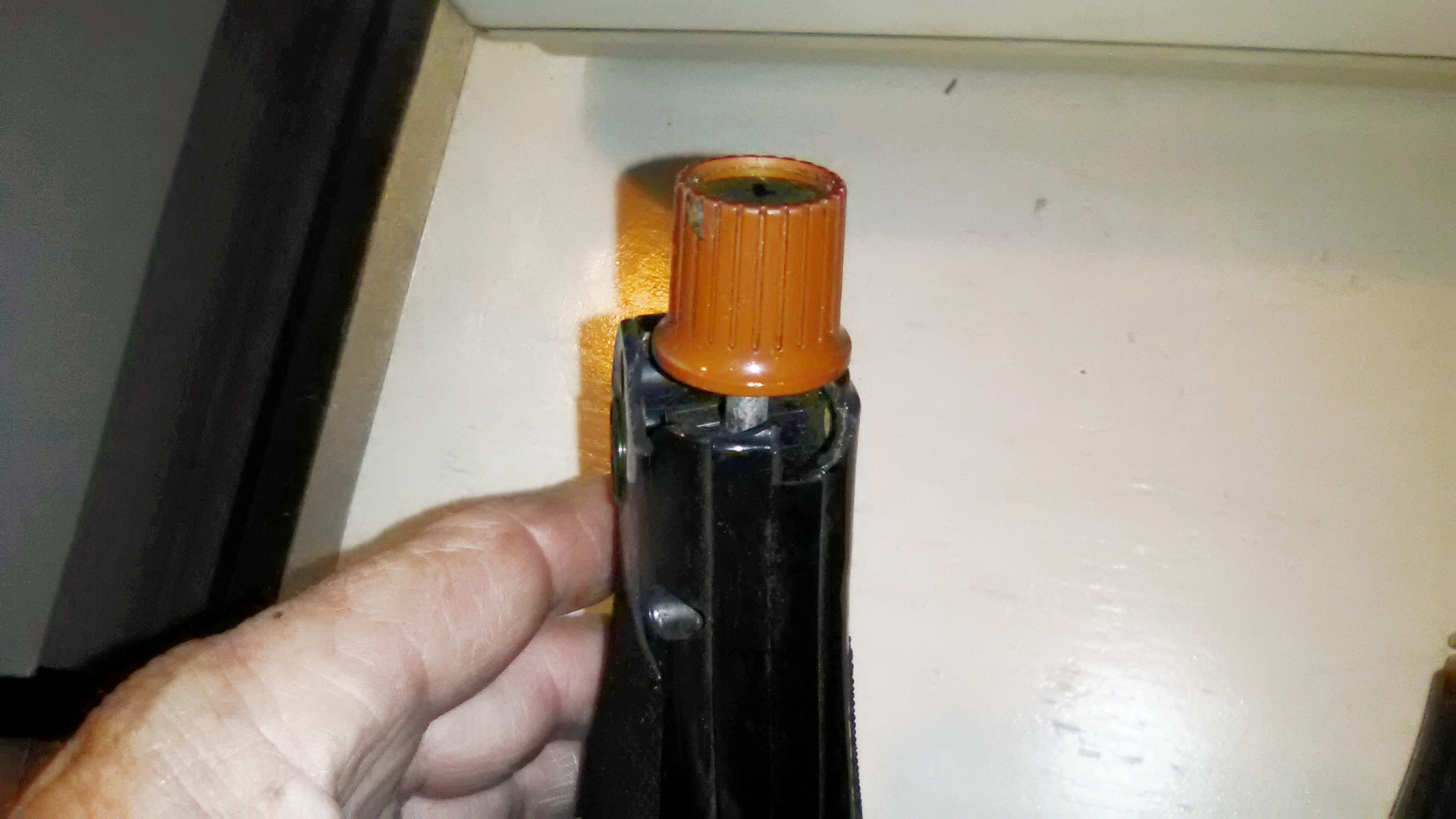

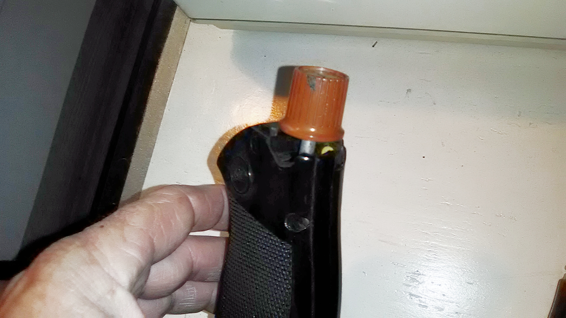

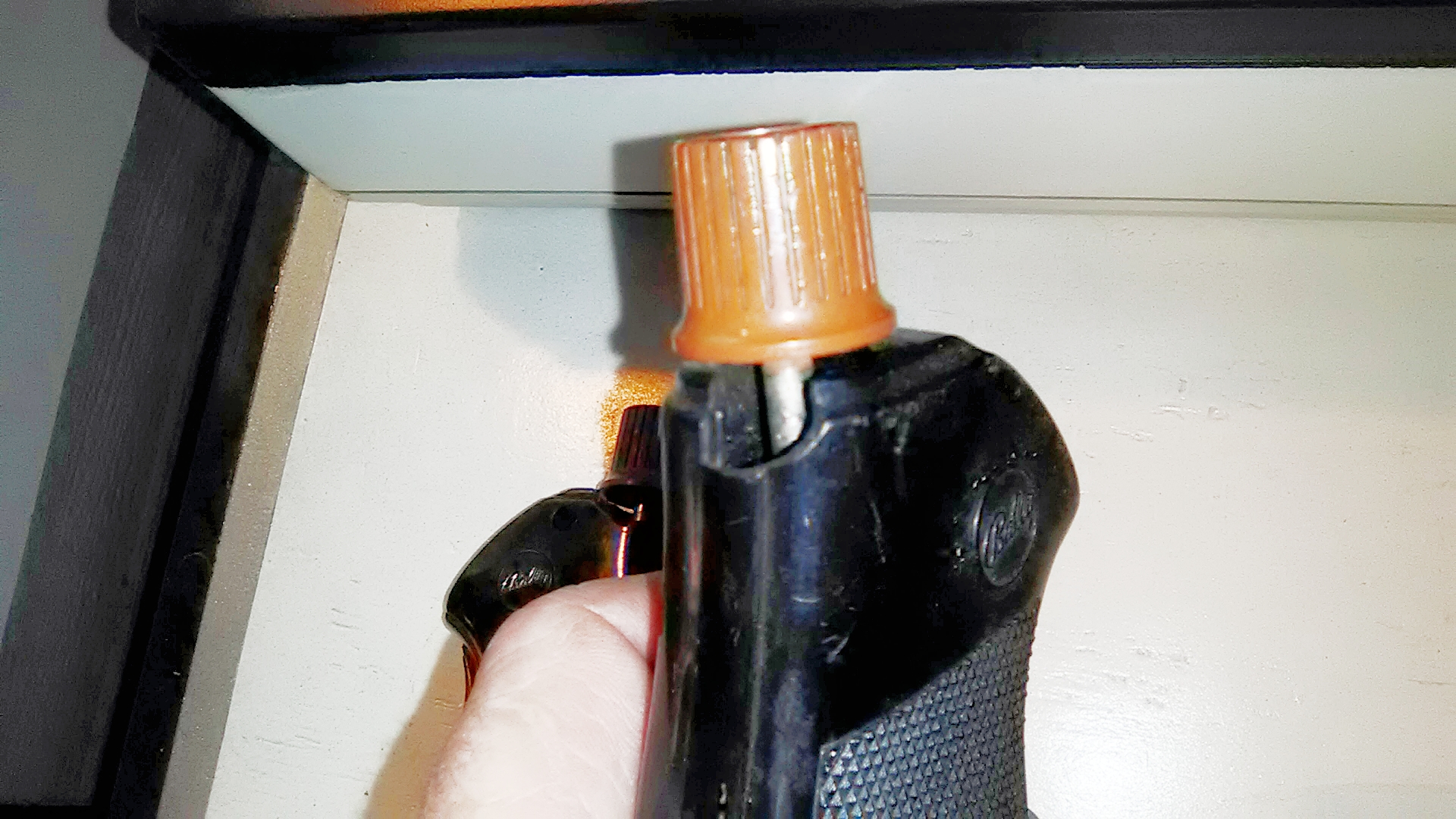

    Here are shots of a complete tear-down, short of the main assembly.I will be testing and cleaning contacts while it is apart, after I do the body-filler on the controller handle, while I wait for it to cure. I will probably have to tear-down the paddle-pot and clean it as they get tarnished from sitting. I've had to redo Atari paddle pots after just a few months of non-use. But I'll test them first...But it all looks in very good condition and I expect the joystick and fire button to work without issue, even though I'll clean them anyway.
    This last picture is shows the shape of the joystick opening, basically square, with indents in the middle, and those are molded in, not from wear. I'll have to build up a "wall" with the J.B. Weld that is even across, and then use my Dremel with a grinding stone to re-create the proper indent(s), otherwise the joystick(s) won't have the proper throw-distance as other directions.

    Another of my projects I'm finally finishing up this winter is the restoration of my Bally Professional Arcade. It had pretty much been left cosmetically complete, full capacitor replacement and full cleaning inside and out. At the time I didn't have a PSU to even turn it on and test it with, and that was part of the restoration, building a new PSU for it I also had left the controller disassembled in a box needing a good cleaning, and re-assembly for the electro-mechanical parts, but the controller cases were broken and I didn't want to use them either until properly fixed and reinforced to prevent the same obvious stress point from breaking again (both controller are broken in the same spot, and I have been communicating with an avid Bally fan and restorer/seller of Bally Arcade/Astrocades and I' fixing a couple joystick cases for him too, broken in the same exact spot as mine. More on that later.)
    Anyway, about a month ago I finally cut and pasted all my posts from this thread over on Atari Age, correcting, editing, adding more pictures and continuing the restoration until I finished in a Bally restoration blog. And when I had first published the ongoing blog, the person mentioned above contacted me offering advice and help and allowed me to borrow an original Bally PSU for testing, which he ended up selling to me for a reasonable price of $40 for one in mint condition, a steal considering the rarity since they are permanently connected to consoles they just aren't found separately except when salvaged like he has done, from console used for parts for other consoles. I searched on and off for over 15 years and never found one and finally decided to build my own a couple years ago as posted above in this thread somewhere. I still have all those parts and will save them in case this Bally PSU I have now ever goes dead, because they aren't really repairable or rebuildable.
    He also sent me RESET and EJECT buttons that still had flawless gold chrome trim on them so I didn't have to resort to gold paint on the lettering and it's shiny like the golc chrome auto trim I used for the console's trim. And new controller numbered 1 and 2 paddle knobs since they have metallic badges on top and mine were also in poor condition. In return I sent him my old bits and I printed him Bally cartridge case and am repairing two of his controller cases.

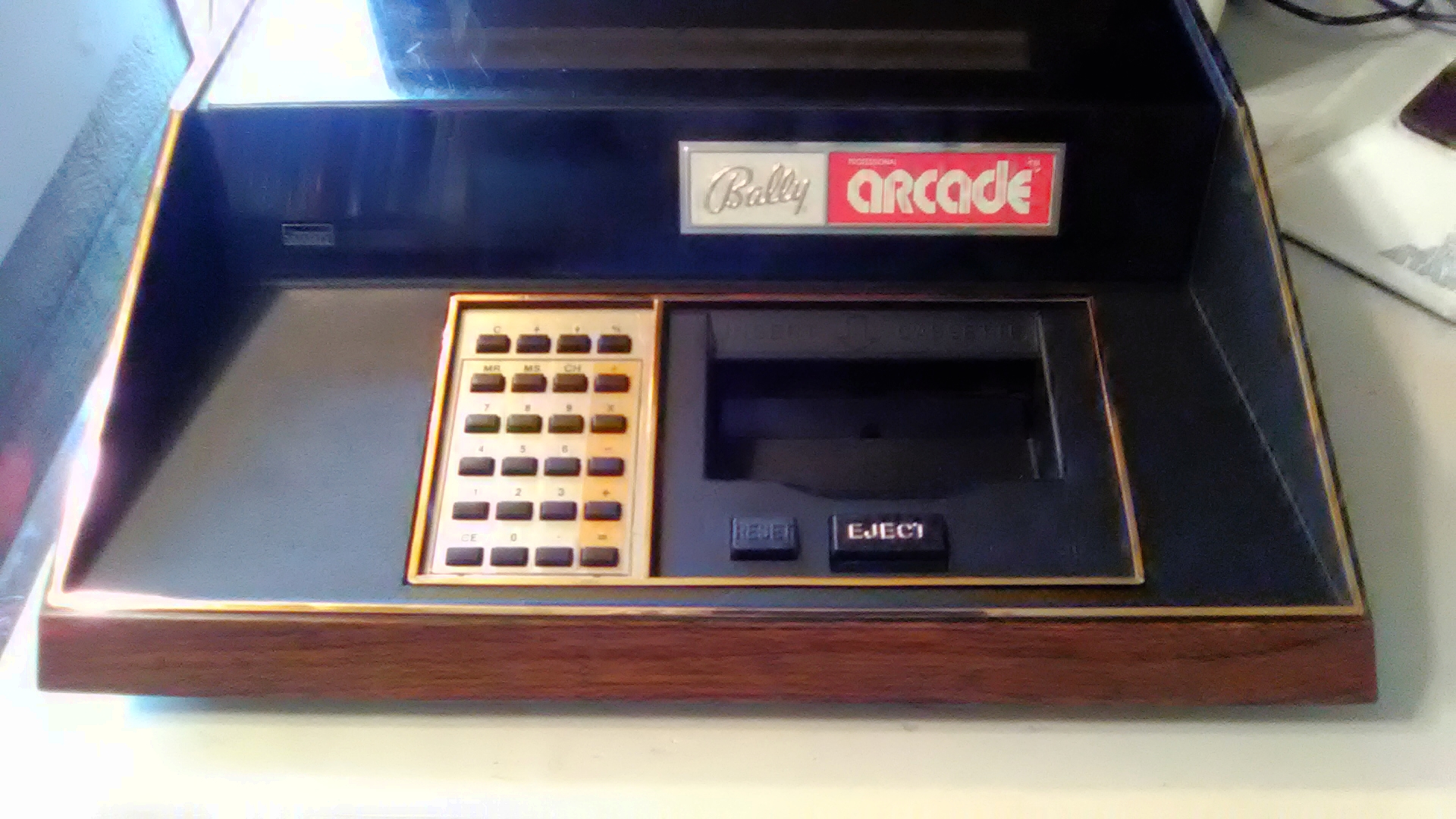

    Anyway, once I had a PSU for the Bally, I was able to test it out. There was no picture when turned on (the Bally has no power LED either). But I noticed that the Bally power switch would cause interference on the TV screen when jiggled, so it seemed like it needed cleaning or repair or replacement. Luckily it was just needing a good cleaning having tarnish buil-up on it's metal contacts.
    Second, the RF module channel switch was very hard to move and I wasn't sure if I was getting it switched fully to one channel or the other (3-4). And I also noticed TV interference when the RF module was jiggled and the header on the motherboard where it connects moved and seemed to loose, possibly cold/broken solder joints.
    So, after cleaning the power switch I cleaned the RF header teeth, resoldered all the solder points on themother board header and secured it all to the mobo with epoxy. I then removed the RF boxe's channel switch (which ended up breaking on me anyway) and permanently shorted it with solder to only work on RF channel 3. I then tested the system out again and it worked!
    But the Bally in general, and it's ultra rare custom IC's are known to run hot, one of them had a heatsink connected between it and the RF shielding out of the factory! And mine all grew quite warm quickly and two poorly heat-sinked regulators were quite hot to the touch! So I ordered a bunch of several different sized IC heat sinks (I'm using them on my other systems too) and gave all the main IC's and the regulators heat sinks to keep them cool. It was also recommended to me by my new Bally friend to NOT put the top RF shielding back on as this is also part of the cause of over-heating issues. I couldn't if I wanted too with all the new heat sinks inplace anyway.
    After that I re-assembled her, cleaned her again and wiped her down with Rejuvenate and a micro fiber cloth. The RF image is surprisingly good on the Bally, I believe the cleanest I've ever seen and looks nearly as good as any composite video I've seen, so I'm holding off on making a video out board to replace the RF box for now. There are upgrades both internal and external for the Bally that turns it into a full-fledged Z-80 computer with keyboard, so I will do those upgrades one day, and add an RGB video board to it at that time since it does have component signals off it's graphic chip that can be made into RGB output.
    Check out my blog in my profile on Atari Age for all the details and more pictures. Since it will be a full-fledged computer one day, I have given it space on my XL Command Center (full pictures of it still to come...I'm not finished yet!) desktop opposite the TRS-80 Coco 2. As I also have much more all around space since moving a few things along with the 800 out to my office/shop/lab trailer.

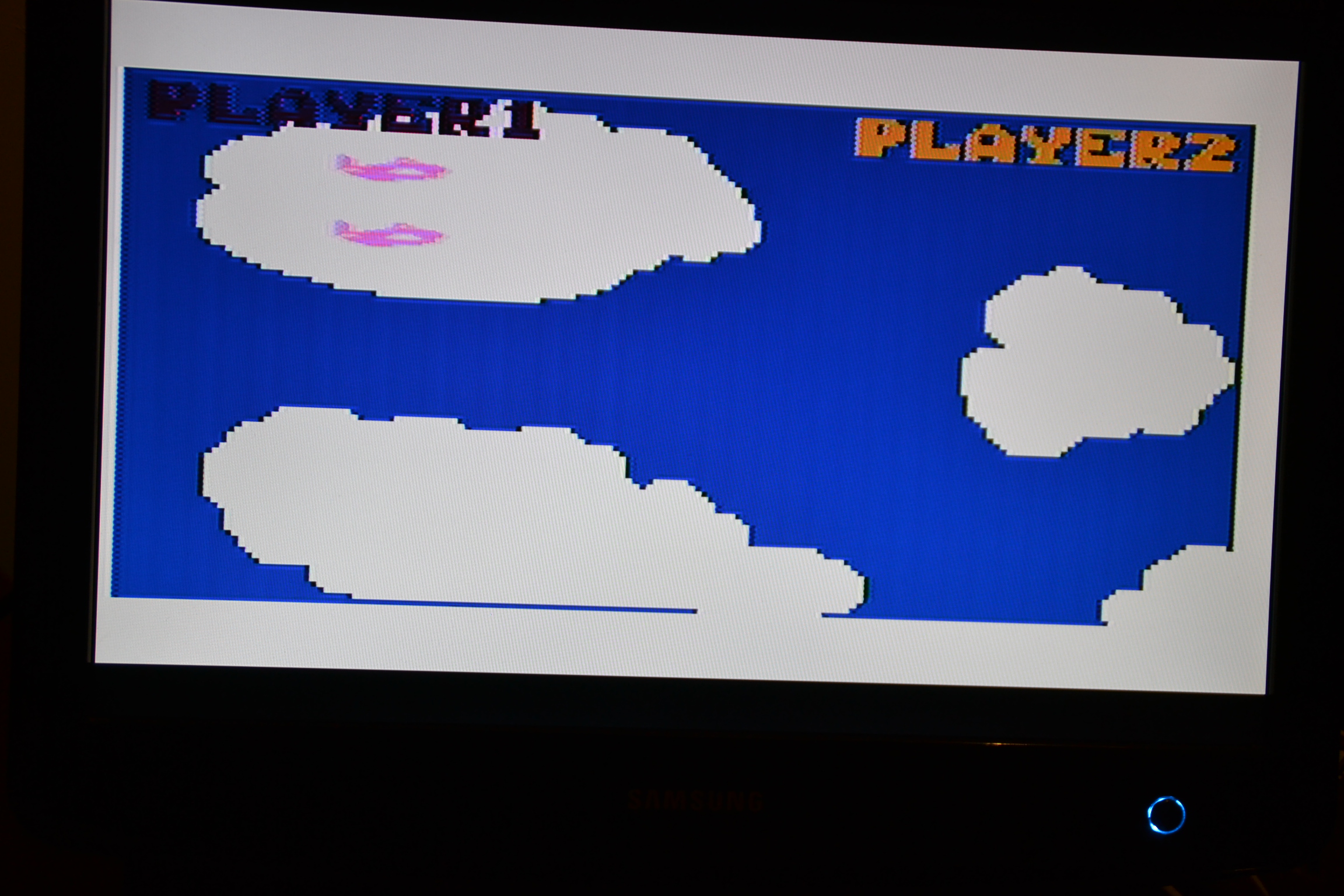

    I tested it out on my big CRT TV.
    20220128_143105.jpg 20220206_125226.jpg 20220206_125242.jpg 20220206_125249.jpg 20220128_144228.jpg 20220128_140609.jpg

    The only Atari art I ever did was the clouds / sky "playfield" to Dogfight (which is still nowhere near complete) and I think I used another program that was highly recommended at the time in the UK - G.A.D. - Graphic Art Department from Red Rat software of Manchester...erm, there I go again! G.A.D. was released by Databyte and Red Rat did Technicolour Dream - another two titles I frequently get mixed up!
    I can definitely say that works neatly but my quick background backdrop is a basic testimony to its capabilities.
