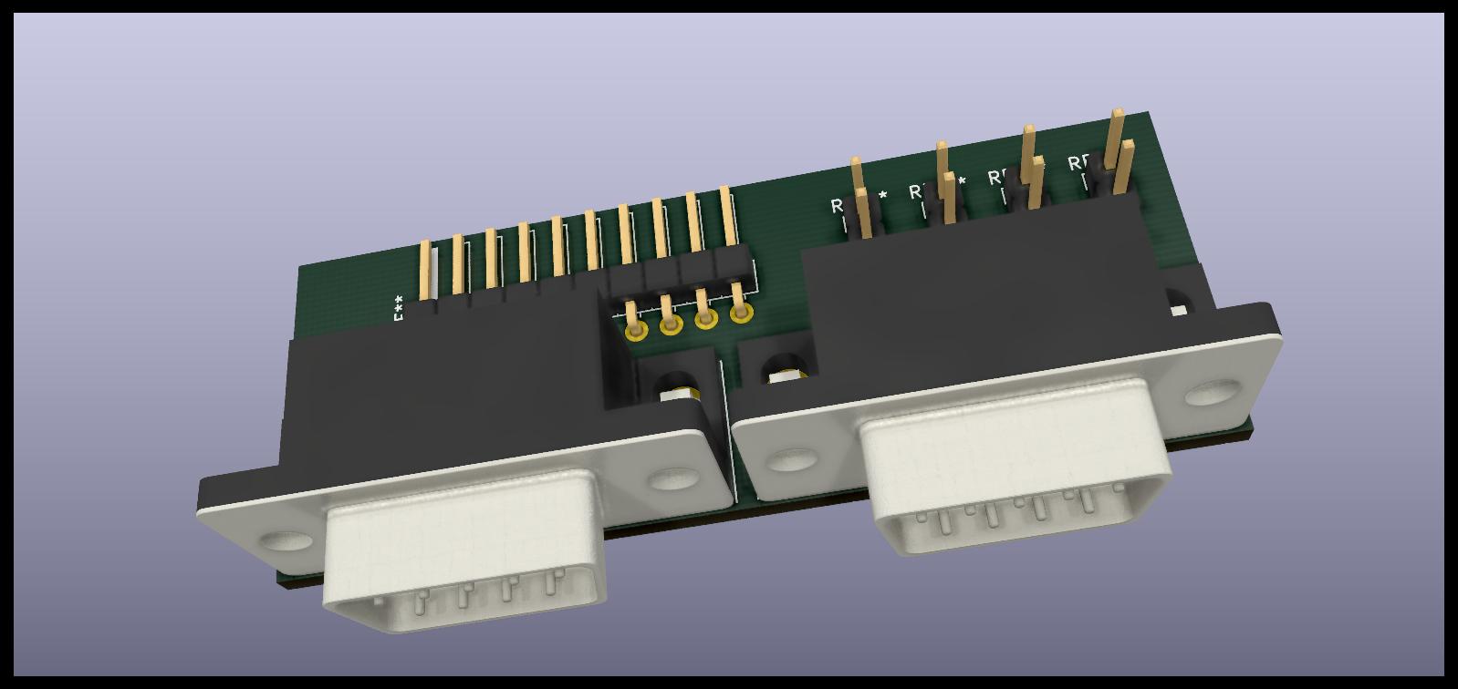

    So should be o.k With above, can leave off PSU in and Just add additional Dupont Pins on the board what do you think ?
    How about this ? 4 lots of Power Pins, can join to other board etc, I can easily add mounting holes so you can join the two boards one above the other buy using short lenths of solid wire, you can fit what ever pins you need to the board, or even solder direct. If you have the space can still add a connector, but worried it'll be two near the case edge ?
    Sorry missed one of your posts re PSU, It tends to be a good thing to power something like a robot or at least something with motors in them from a seperate supply Can easily be done externally using your atarilab interfaces. best not to use the same PSU as although there maybe enough, I've not included any form of Power Supply 'conditioning/ Filtering' and Motors with cause electrical noise on your Atari's power possiably even crashing the computer.
    Plus you have to remember that the PSU is rated at approx 3A (9VAC at 31VA very approx) but the internal Power Regulator is only 1.5A for the 5V line its a LM340T-5 the 12V LM341T-12 only 500mA
    That looks and sounds perfect.;) Don't worry about adding the connector.
