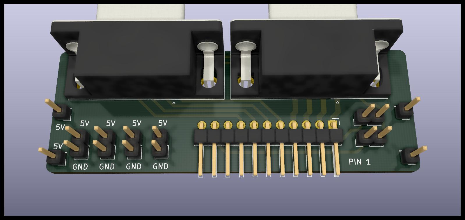

    Looks fantastic Graham! So, how does the ten pin connector work? is that 9-pins for controller port and the 10th is some sort of switch or selection line for the controller ports? Will this allow both ports on each board to be used at the same time? Or is it that there is another ten pin connector that will go on the bottom side? And if so, then what is the tenth pin for?
  6. by Graham
    Oh Dear I went and changed things again.

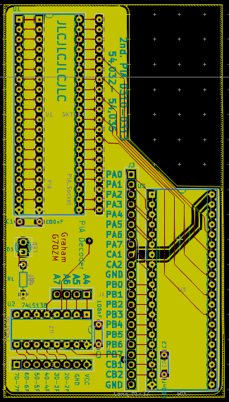

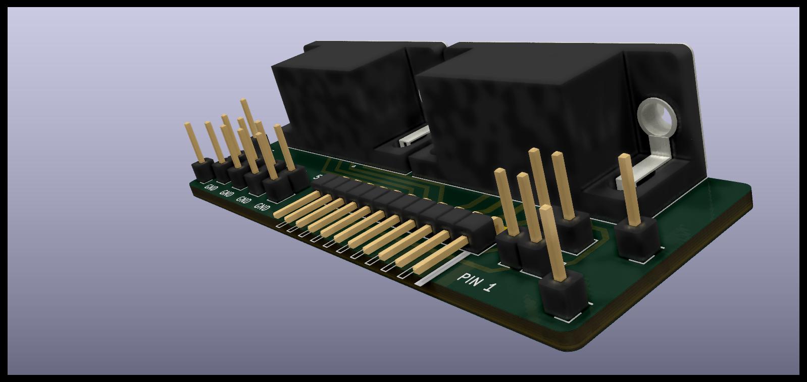

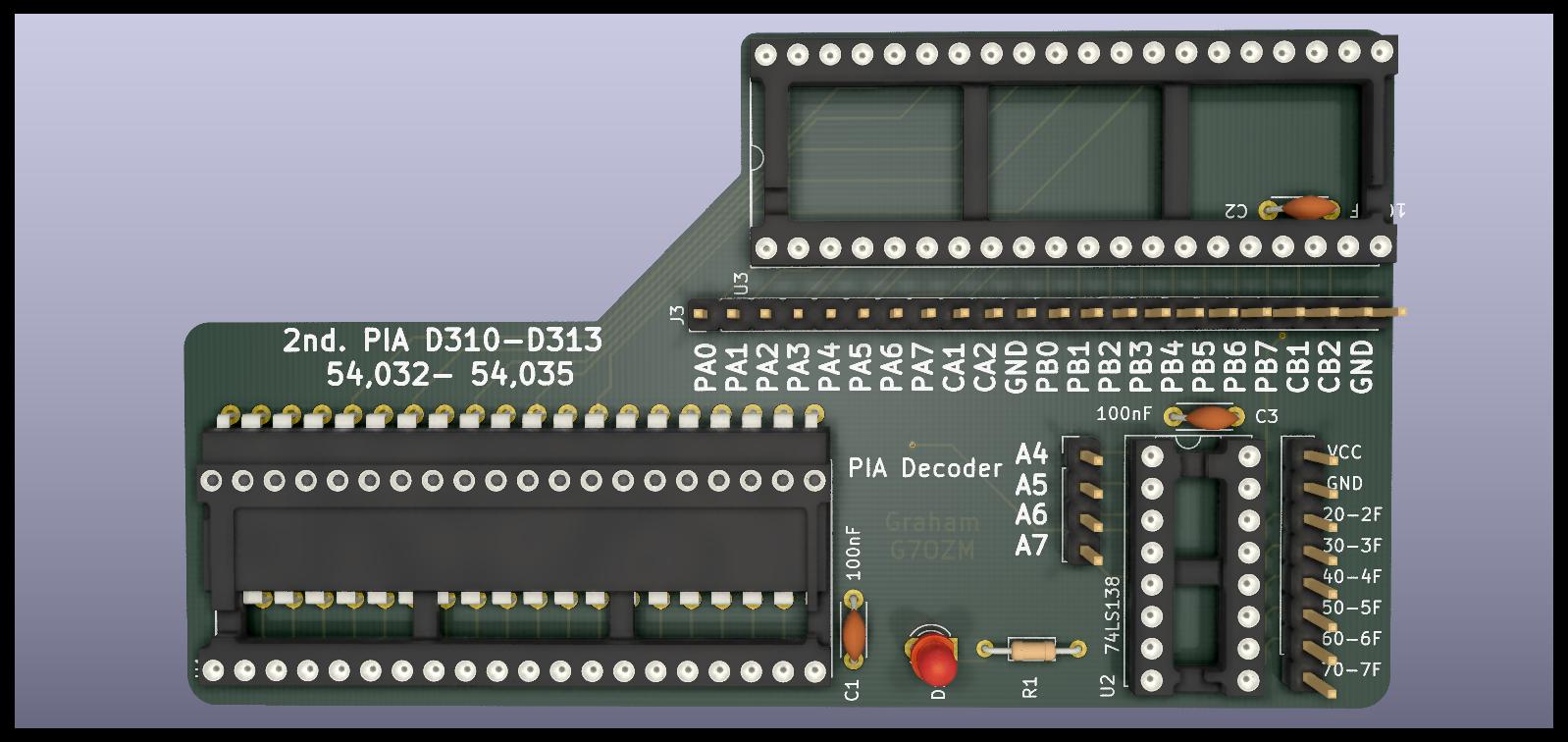

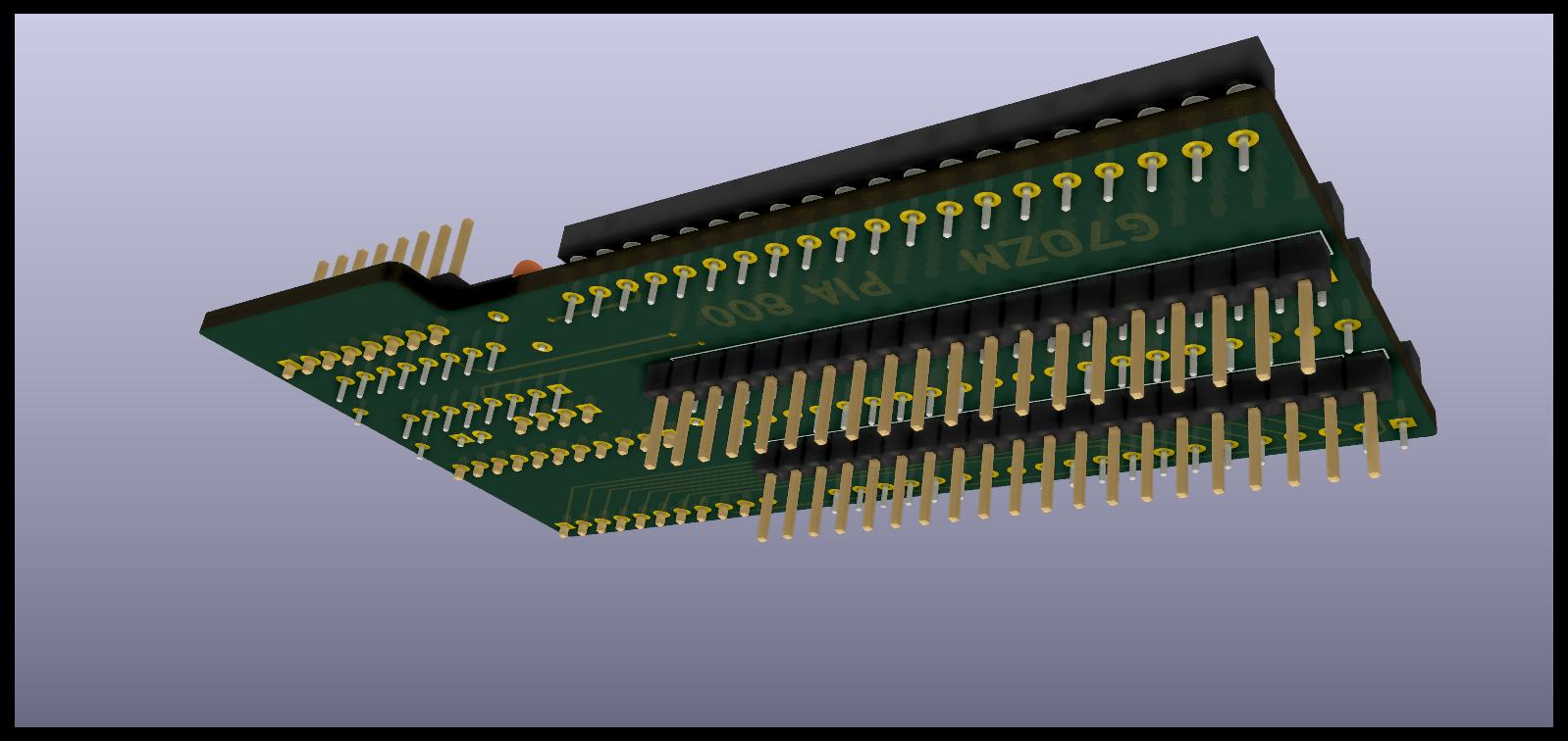

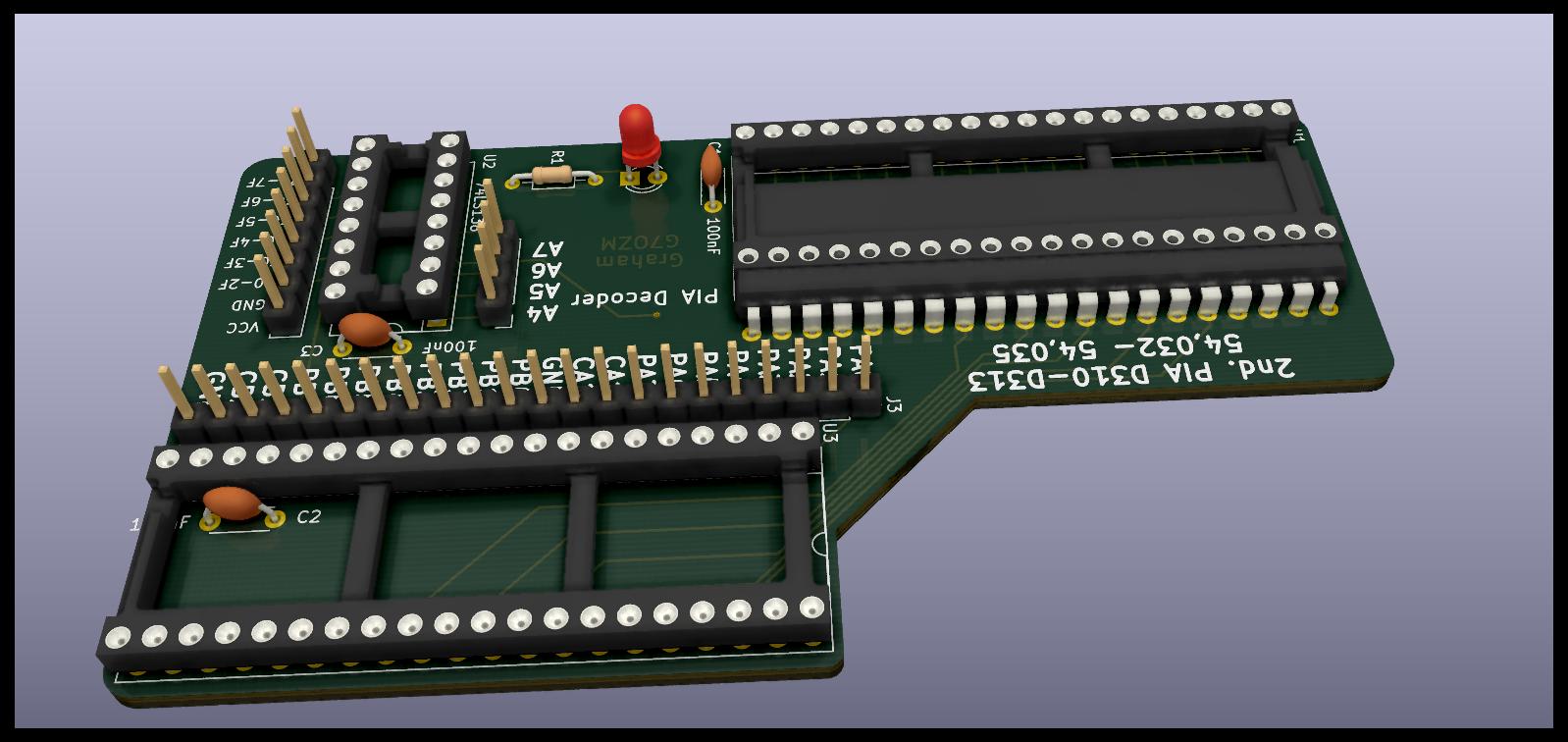

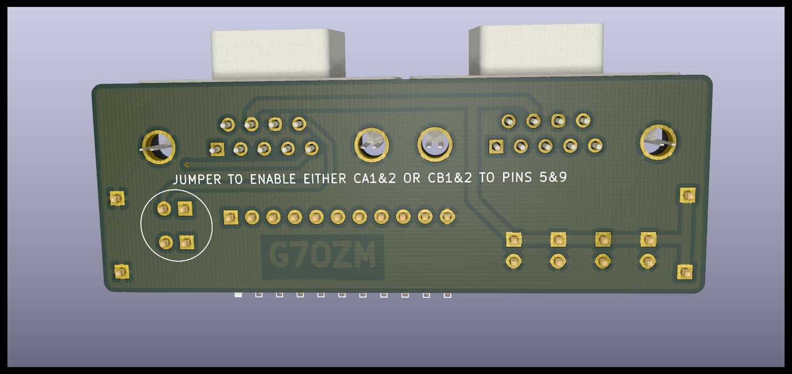

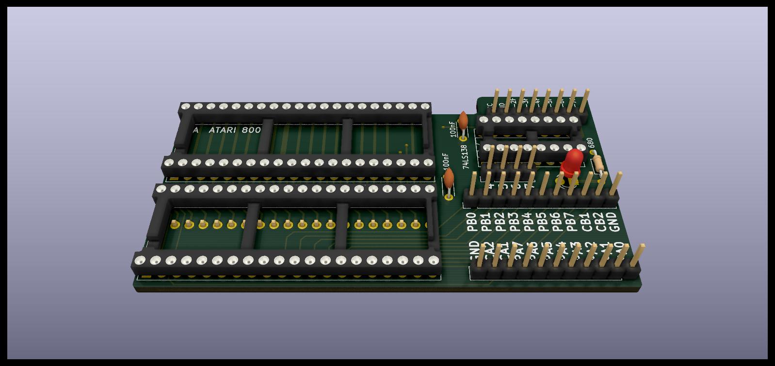

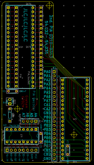

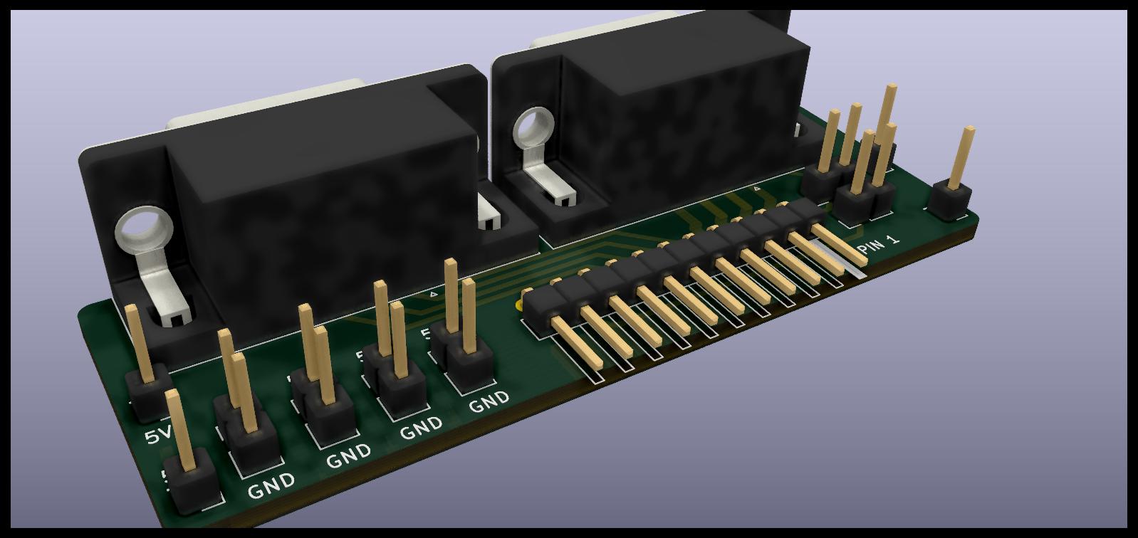

    There are now 11 pins, 8 of these are either PORTA or PORTB bits 0-7 the next 2 pins are either CA1&2 or CB1&2 and the final one is Ground.
    I've just revised the decoder board to match it now has a 22 Pin connector, allowing two bunches of 11 Dupont connectors one for each board. I also added some additional mounting holes to allow the two boards to be stacked, and soldered with long dupont style pins.
    CA1&2 can be very useful, as they can be setup to either input or output a stream of serial data, this is fairly easy to latch in either direction output via 74HC595's or for input 74HC165's, note they are CMOS chips.
    I'll see what I can do later on to show you.
    decoder 1.png decoder 2.png PIA_Address Decoder_7.jpg PIA_Address Decoder_7a.jpg PIA_Address Decoder_7b.jpg PIA_Address Decoder_7cjpg.jpg

    It's looking fantastic Graham! Certainly much better and cleaner looking than my own DIY stuff would have been with Piggy-backed chips with bunches of wires going every which way and to the ports, following some old DIY instructions for dual PIA's! It will make a nice clean upgrade to my 800 with more advanced abilities drawn out of the PIA than I would have had on my own. I really feel like you deserve more money than just cost of the boards for all the work you've put in, and I'd be very happy to pay you more for all of this!
    This is amazing work Graham! Wow, just wow!

  9. by Graham

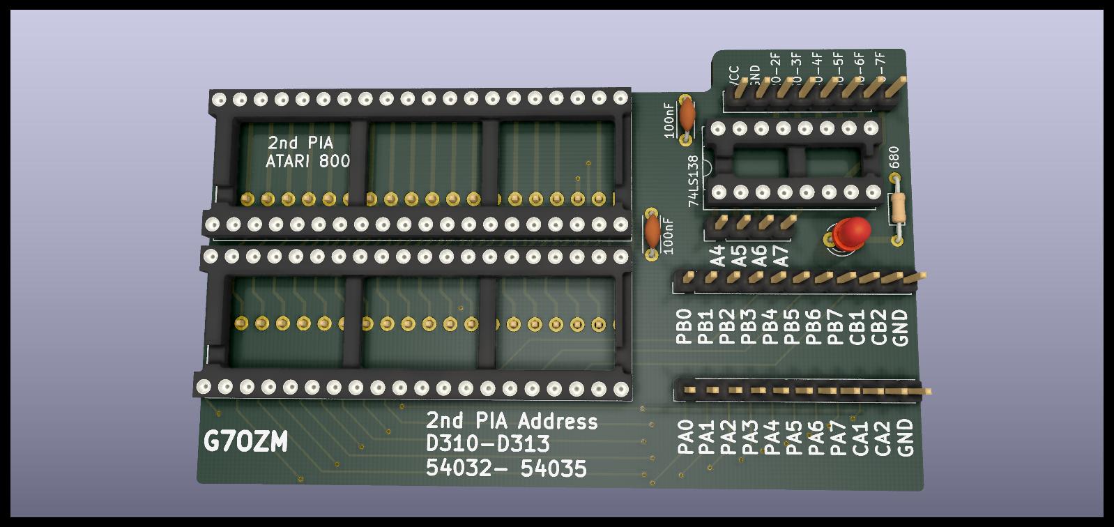

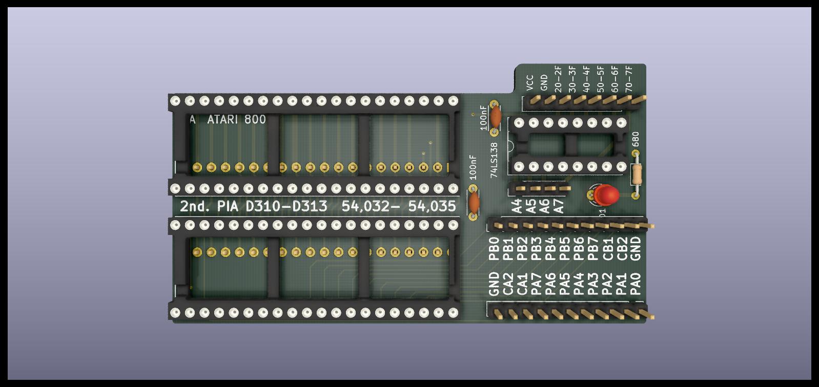

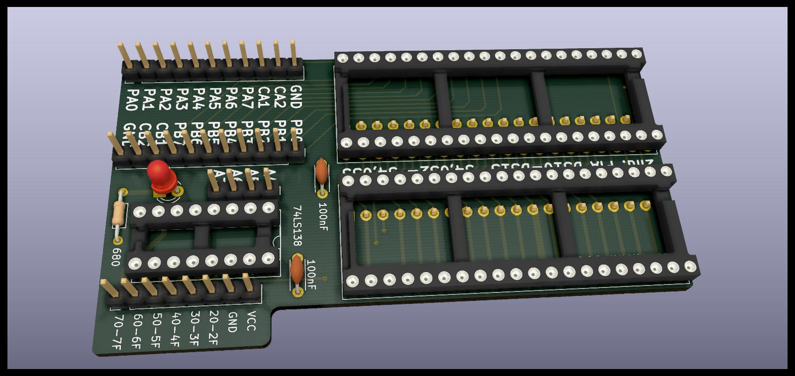

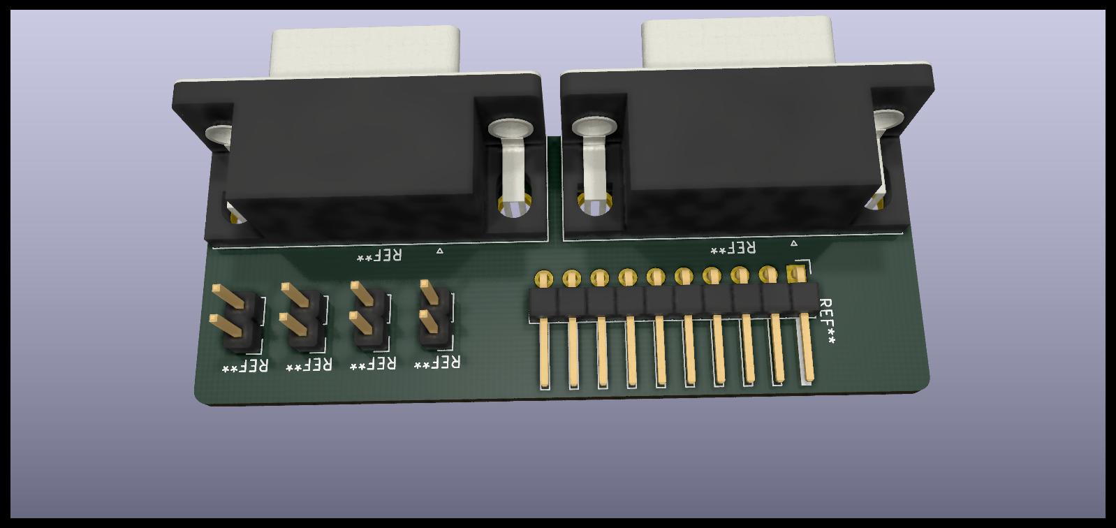

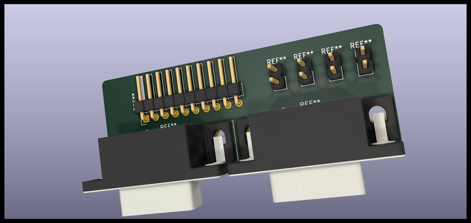

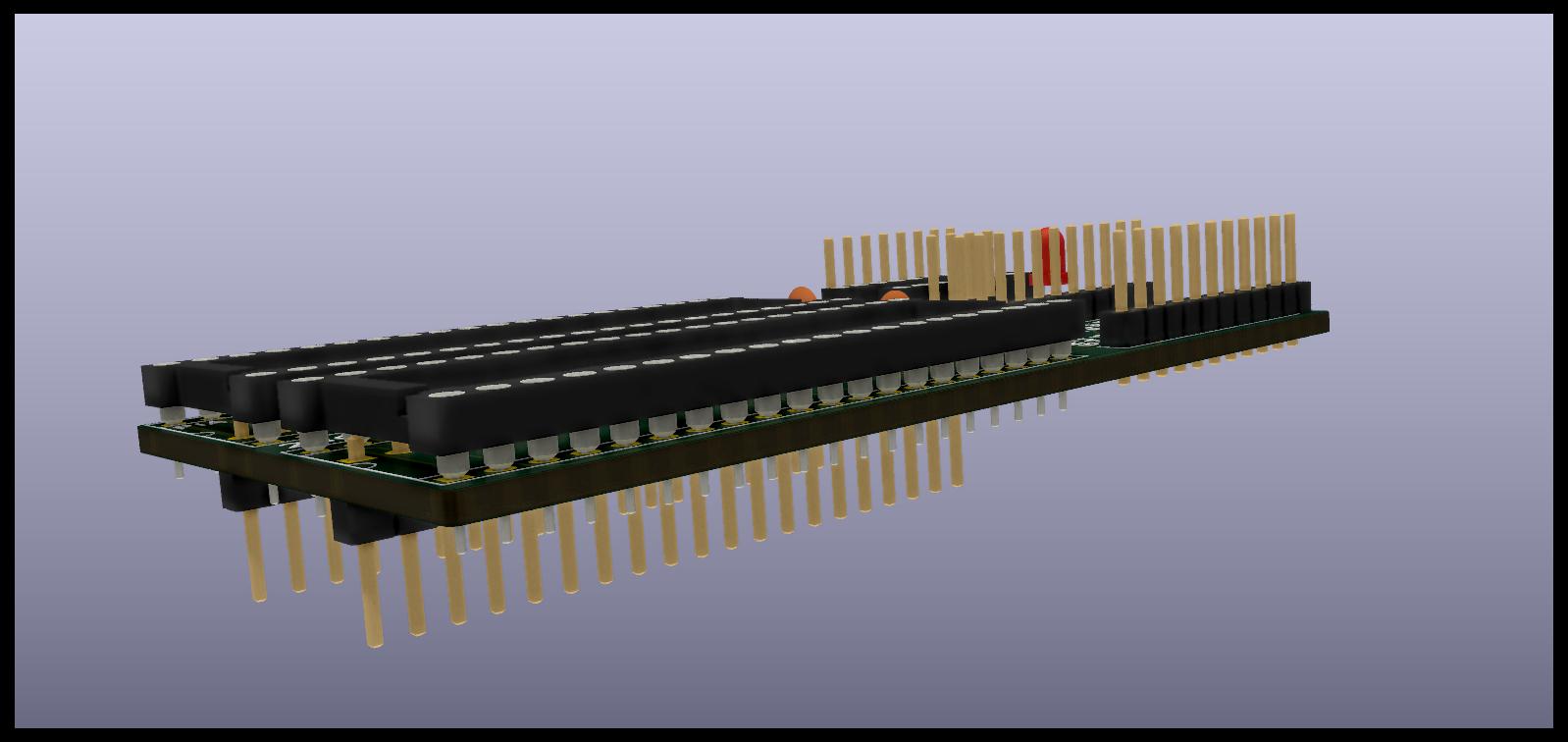

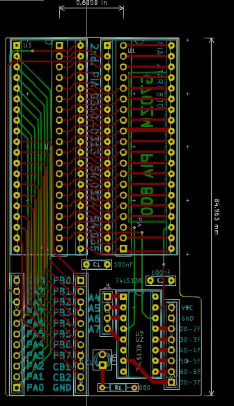

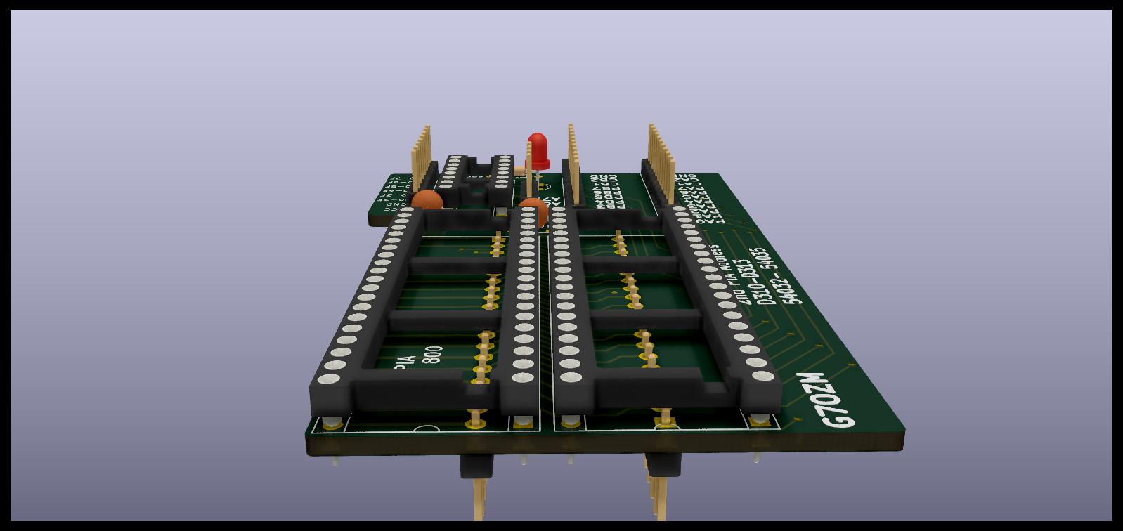

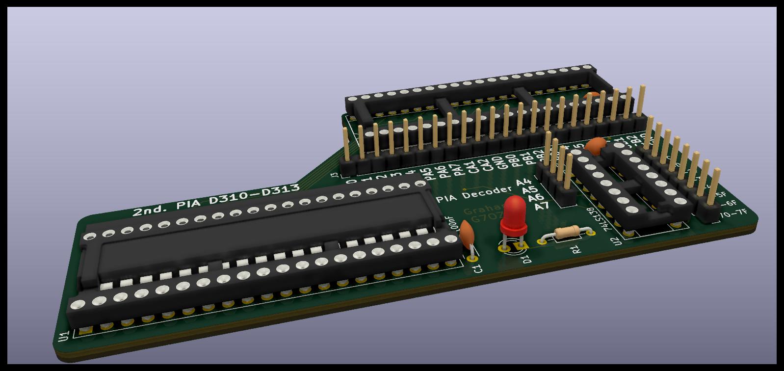

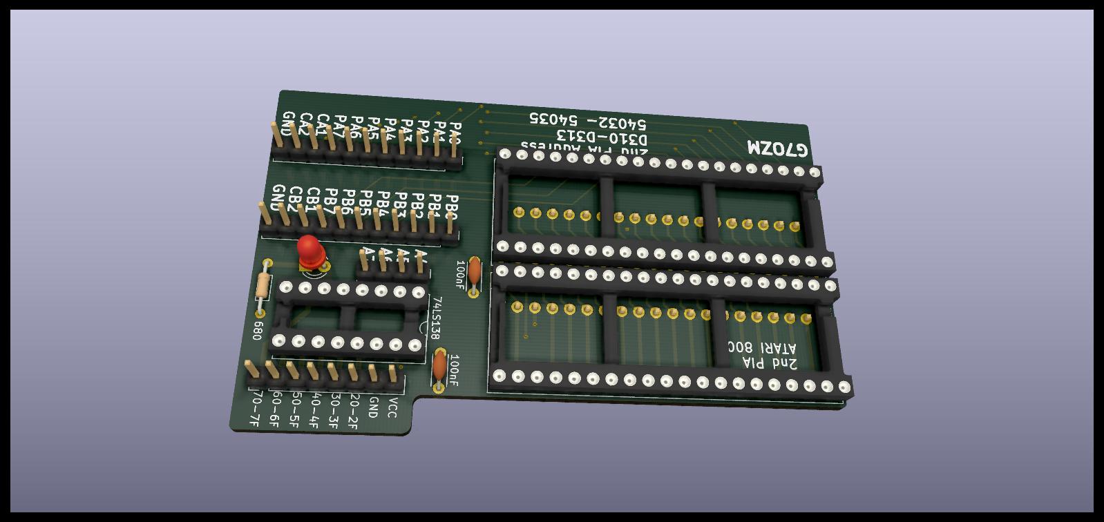

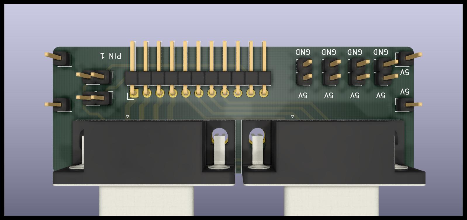

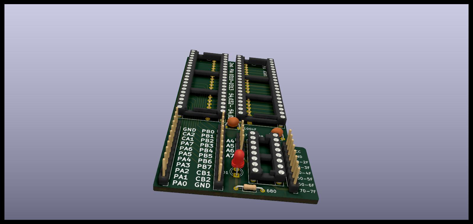

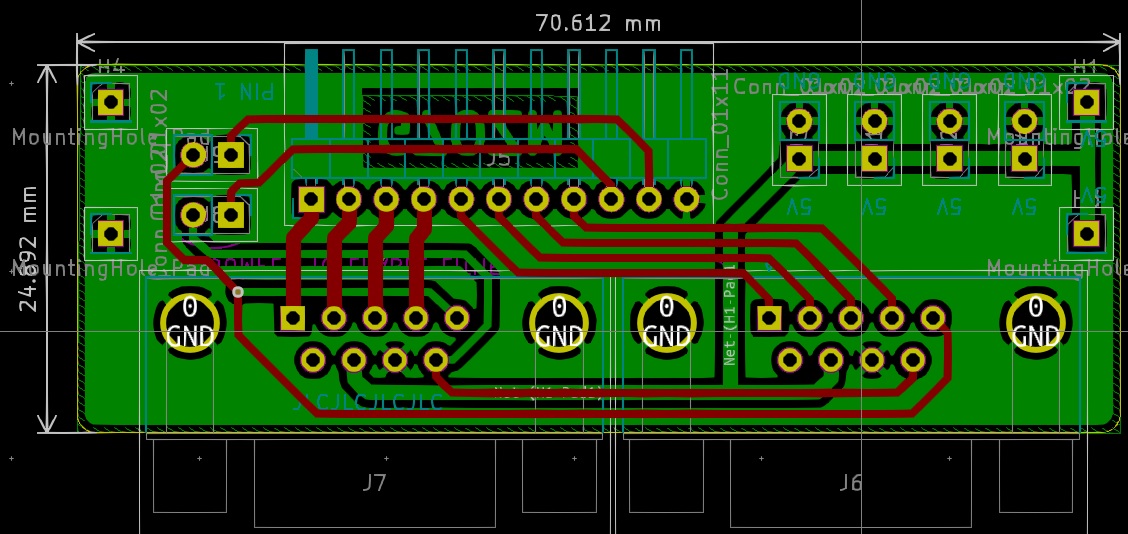

    I decided the bord didn't look very nice with the joining pins so I've layed it out again
    PIA two port board.jpg PIA two port board2.jpg PIA two port board3.jpg PIA two port board4.jpg PIA two port board5.jpg PIA two port board6.jpg PIA two port board7.jpg
    I've attached the circuit(s) in PDF format to download
    Thanks! I'll study the PDF's. By the way, what software do you use for designing these? I really have to start designing my boards too, instead of just thinking them up and sketching them on the fly and building them up with wire and bread boards. Though I did buy a bunch of bread board PCB's of different sizes just this past year...but what the hell, I don't think I spent more than $10-20 on them.

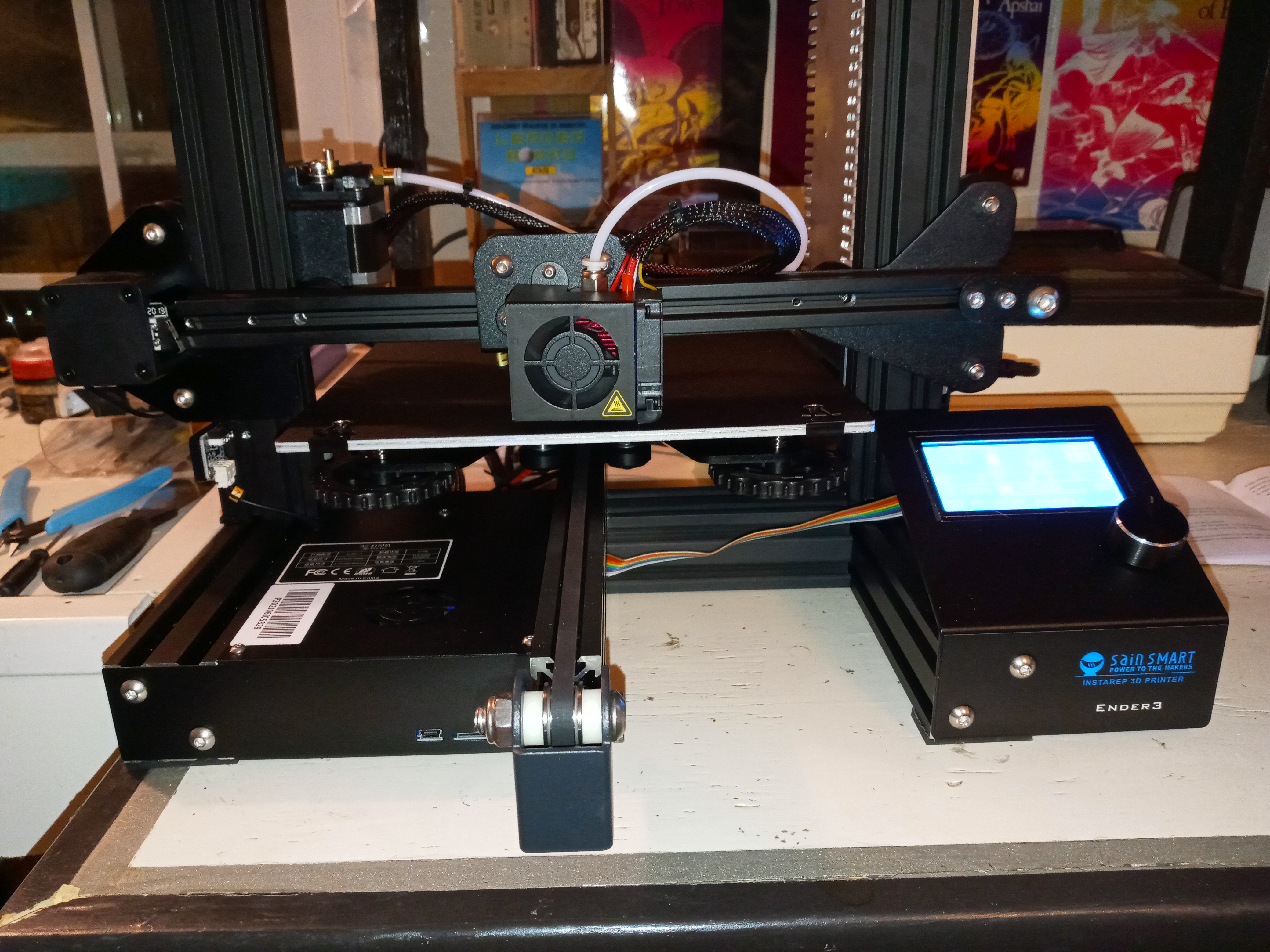

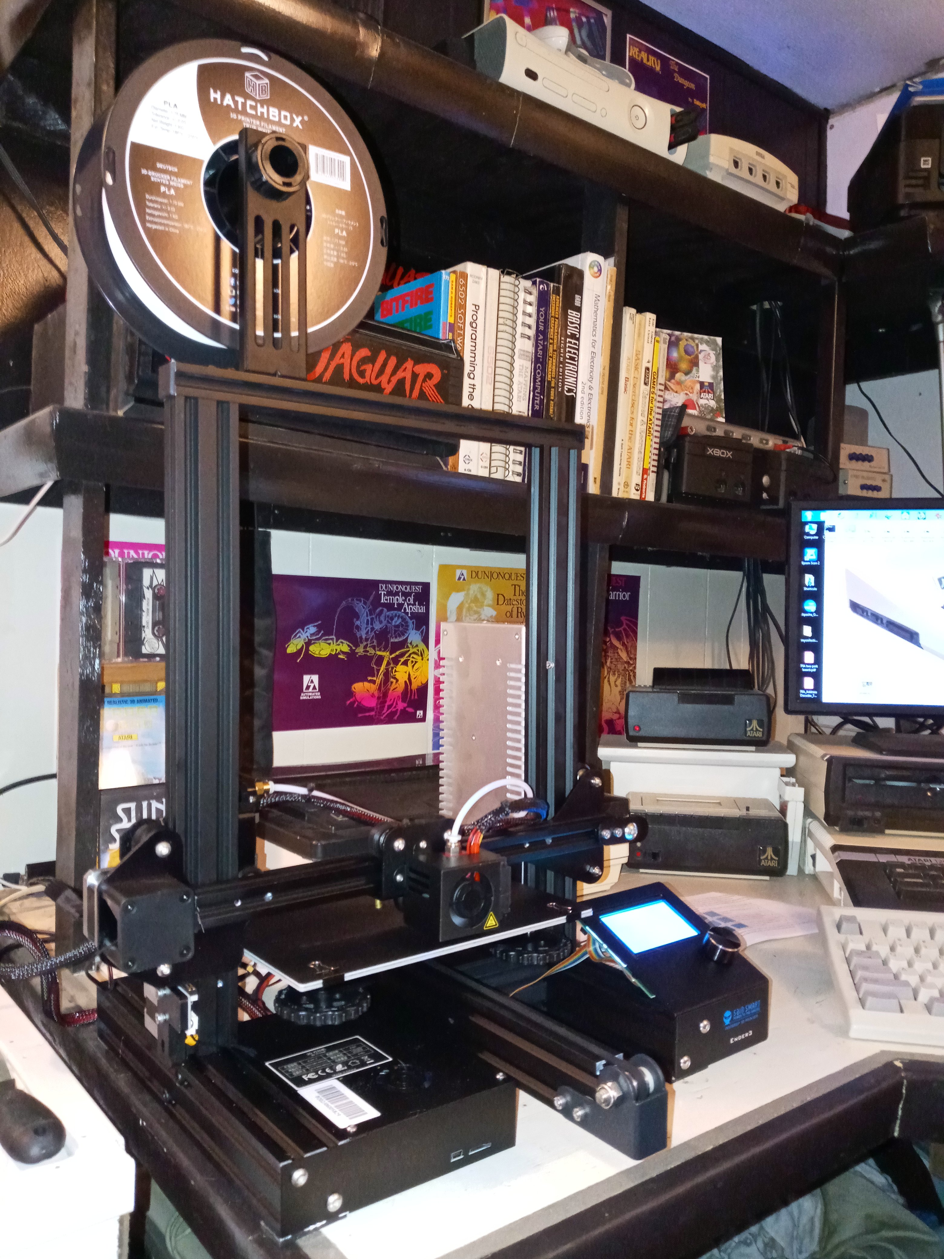

    Cool, thanks Graham. I may not actually get to it for a day or two as I've spent the afternoon assembling my Ender3 printer, and now I'm learning to use it and installing Cura software on the PC to make the 3D designs, that will probably take a bit to learn too. I'm very happy with the build quality of this $275 list 3D printer, it's almost all steel and aluminum with just a couple small plastic bits.

    That printer seems very good value for the money, looking forward to seeing what you can do with it :D:D

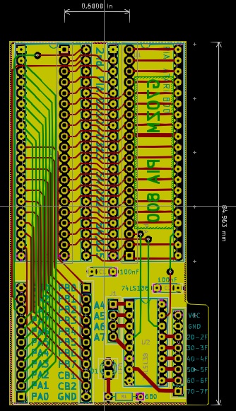

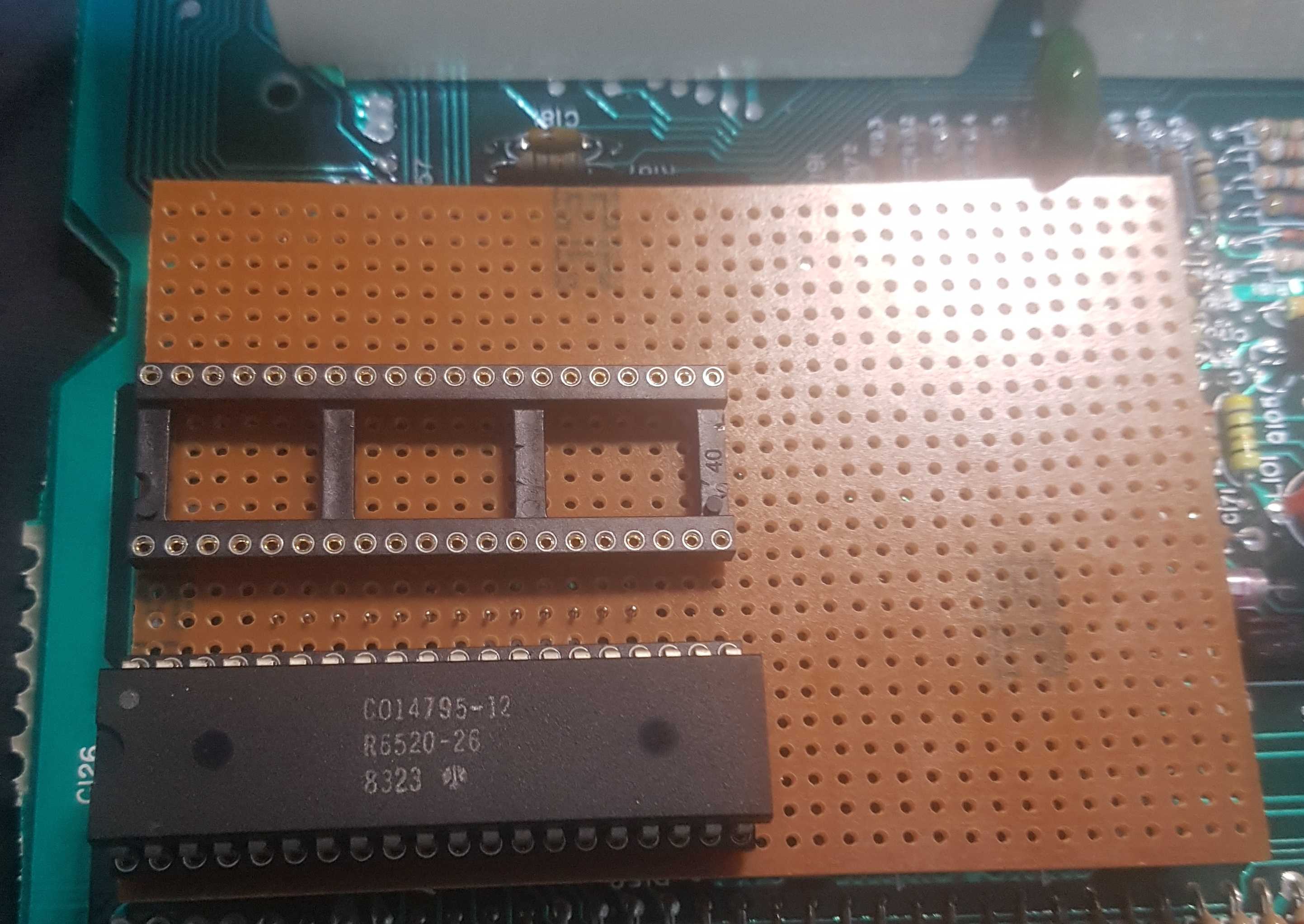

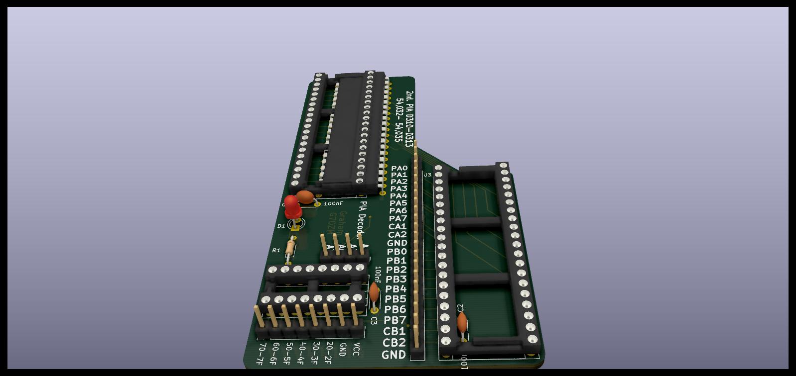

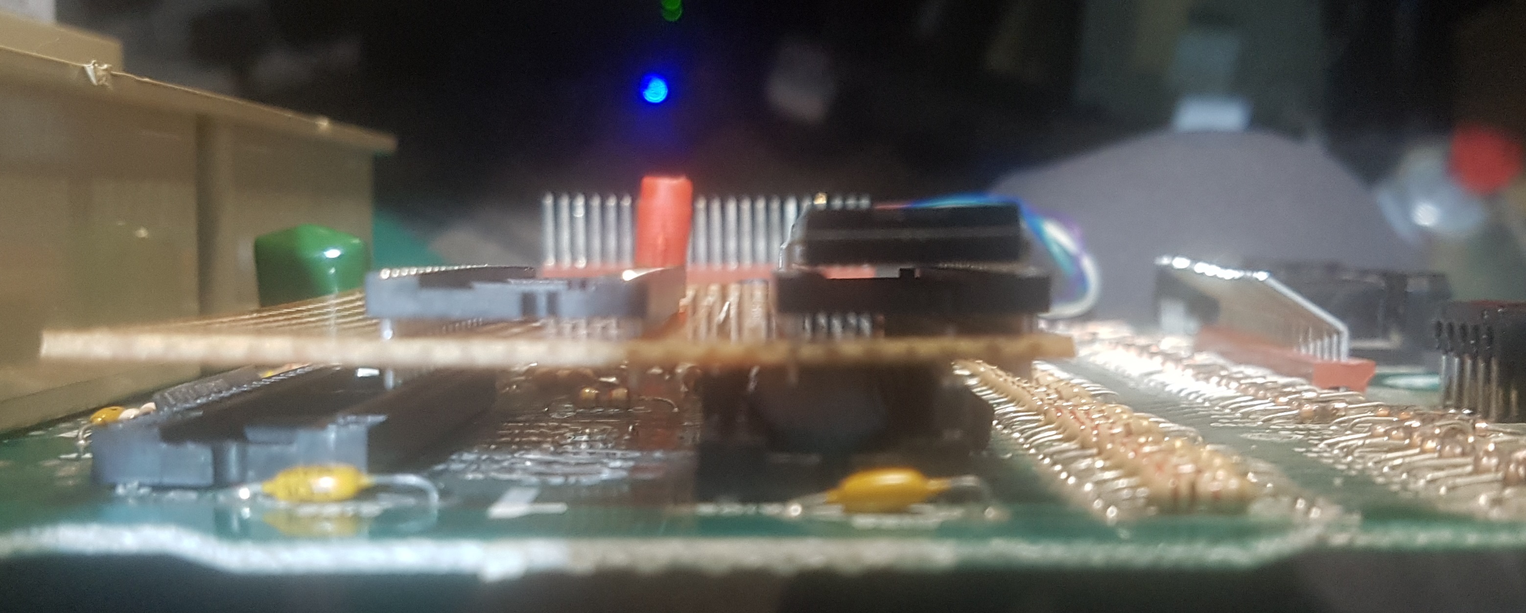

    Matt I'm going to have to change the PIA board again as the traces from the original to the extra PIA are likely to cause a problem, and I pushed them even closer to fit in the 22 pin header so I'll redo these before I send off and find they are't reliable !!
  16. by Graham
    I've just done some more measurements between the top of the 6520 and the aluminium caseing, and appear to have approximately 10mm clearence directly above, decreasing as I move towards the fron of the computer, however I feel I have some additional room there so the original PIA can be moved forwards a little more. that and the Capacitors I'll lay over or replace, will allow the 2nd PIA to sit behind the 1st. See the attached mock up to see what I mean.
    This will also fit the XE range 65/130/GS and the 1200XL however not the 800XL as it brings the original PIA to far forward. Likewise the 1088XEL/XLD would need particular versions.
    Of course the Vero board overhang the pokey socket but the Original PIA in this case is going to be moved back towards the Pokey, It won't however be above it and allows a Pokey Max for stereo as the pins are on the back side away from the PIA.
    The Additional PIA will sit in front of the original, but the output pins will have to go to one side.
    So I've swapped around from what I was doing . :facepalm:

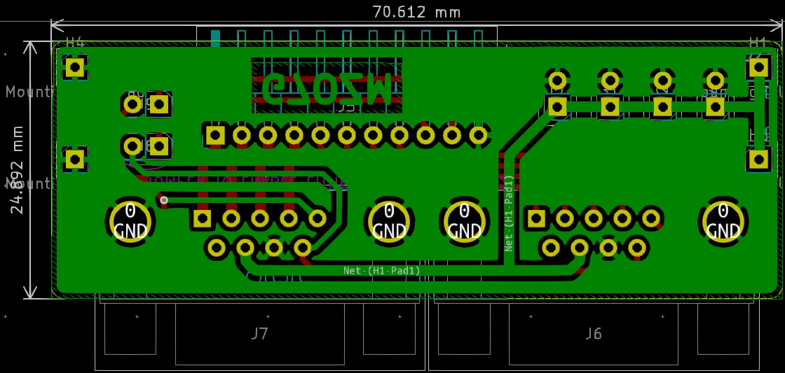

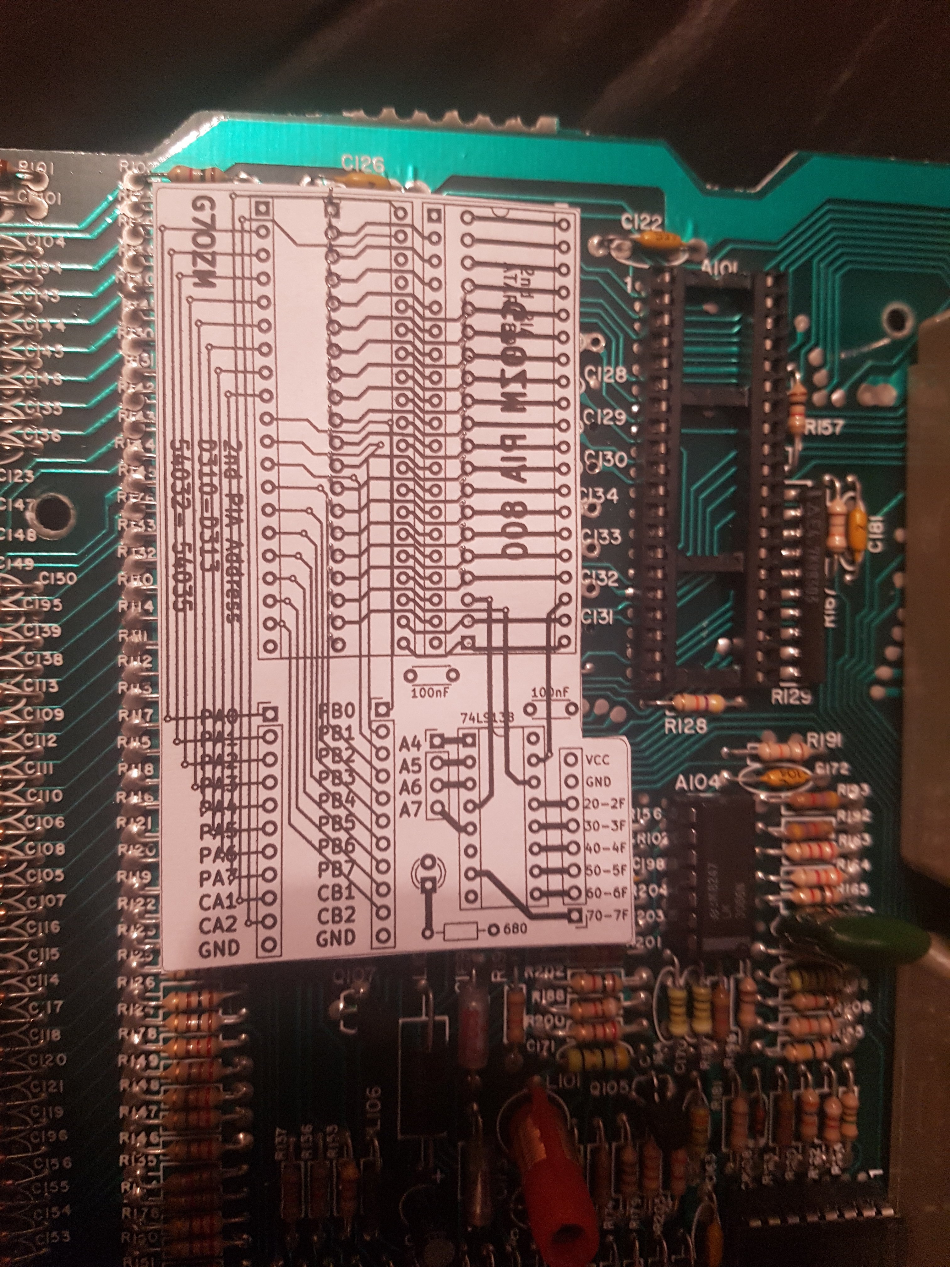

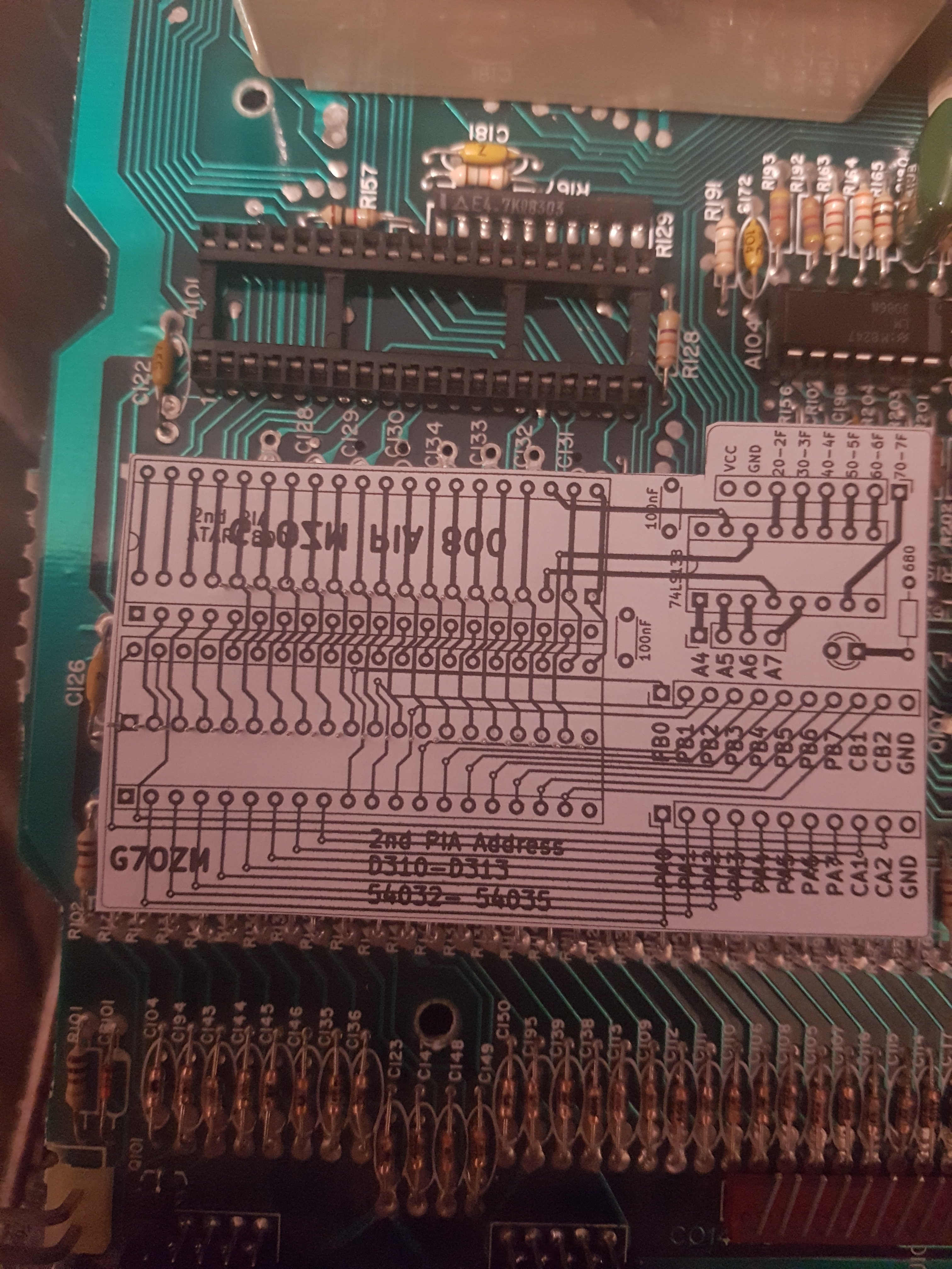

    I had to change the PIA board again today, I run some software to check crosstalk between the traces leading from the additional ports to the connectors, as I routed them with fine traces and close together uder the added PIA.
    I've now extended the PCB forward but only has traces on it so won't cause a problem for the shield. 2021-01-20 16.47.38.jpg
    The original PIA chip moves back towards Pokey by 0.4" and the additional one directly in front.
    The lines infront are not as close as they seem as alternate lines are on opposite sides of the boards.
    Just when printed both sides are printed as if you can see through the board.
    Having printed it off I've attached the print out to header pins placed in the original PIA socket, not in perfect alignment but good enough to check, pokey has a lot more room, although Capasitors still needed lowering to allow PCB to sit down low to miss the shield at the front.
    The two Eleven pin connectors will likely have to have there pins bent towards the back prior to soldering so the connecting duponts miss the shielding.
    Now to work out the best place to find A4 to A7 that are needed :)
