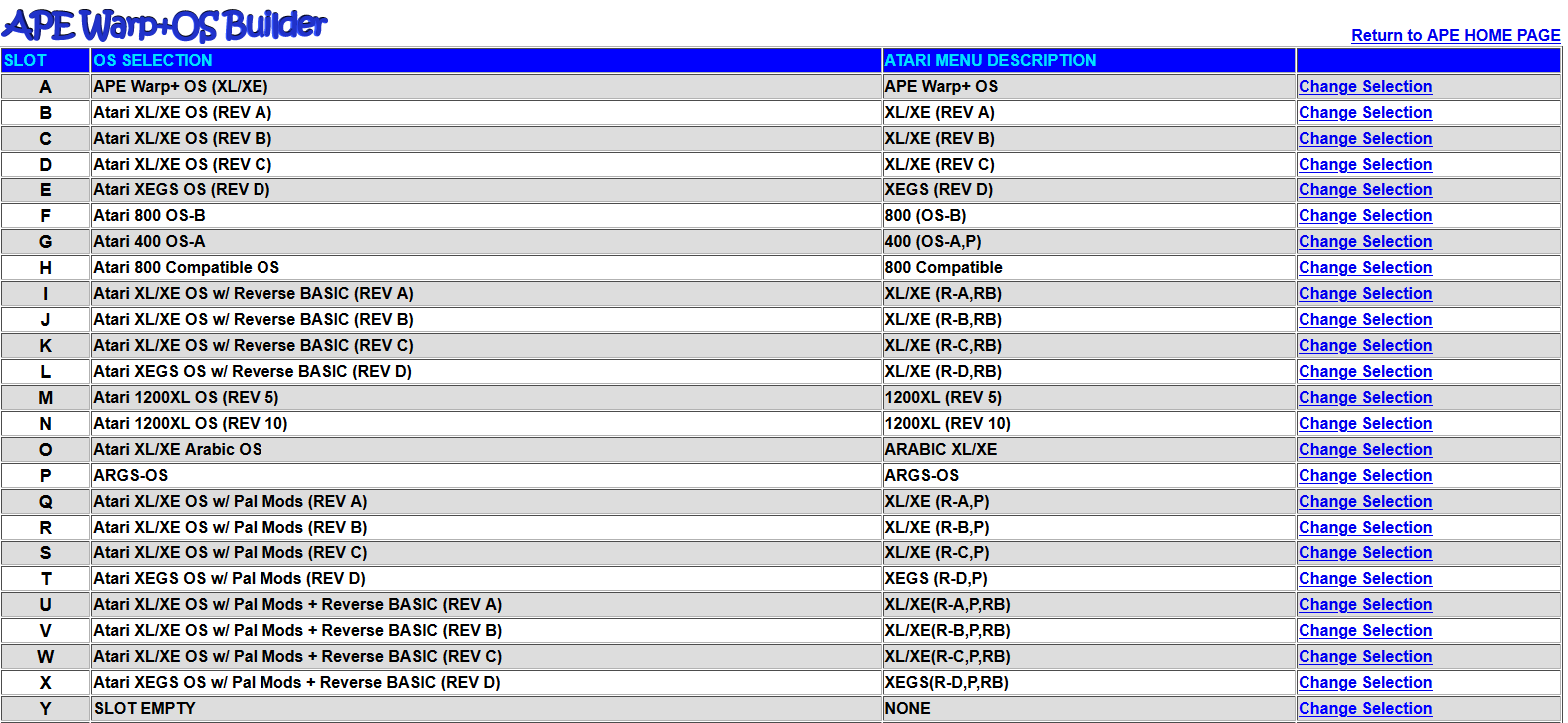

    If you need any EPROMS programmed, I would be able to help you. that includes the ones in the WARP 32-1
    I just need an image of the EPROM data and a chip or can use WARP OS Builder
    I can also program 24 and 28 Pin DIP chips if its of any use.

    So can you have Warp OS and The standard Atari OS in a 27c256 and have a SPST switch and a pull-up resistor?
  5. by Graham
    Yep ! Well one of the O.S's within WARP 32 + one other, you can also do 3 O.S on a 27c512 just wastes 16K
    But of course that could be WARP O.S itself.
    Not sure if there is an image by itself but easy to create an 32x image with that included, and split off from that.

    I’ll have to have a look and see if you can get Warp OS as a stand alone image from Mr Tucker then. I suspect not but I don’t want to get anyone into trouble asking for a it.
    I doubt he will give but it should be easy enough to extract from a created firmware rom image.
    Rename to OS.BIN the one you want is in the 1st 16K however copied it in to the 1st 4x O.S
