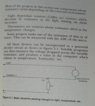

    There is 5V, however if you look at the circuit diagram of the analog port it shows three diodes, from ground via a 2.7K Ohm resistor to 5V, with a 1uF cap across its afairly cheap method of getting 1.8V, due to the voltage drop across the three diodes, and it is this thats used as a referance for the ADC chip on pin 8. hence max reading at 1.8V..
    so a reading of 1.8V would give a value of 255 as data on the ADC. Therefore each value from 0-255 equals 0.00703125V so for a reading of say 100 the voltage equals 0.00703125 x100 = 0.703125V for 120 0.00703125 x120 = 0.84375V
    all thats needed is a divider network to reduce the maximum 1.8V input, and that from the Methane sensor of 5V at its maximum ( I presume not checked sensor info.)
    See below
    Above we see Vin in our case from the Sensor to Vout the input to the Beeb ..
    The relationship stays the same i.e. 1.8V is 0.36 of 5V our resistor network must match this so should we plug into the formula 0.36 = R2 divided by the Sum of R1 + R2 so 564 / 1000+564 = 0.3606 so close enough.
    1000 Ohm and 564 Ohm; realistically we don't want to 'load' the sensor output with a low resistive value, and would want standard value resistors ...
    Trying to find values that would work that are standard resistor values try R1 as 4700ohm or 4K7 / 4.7K and R2 as 2700
    or 2K7 / 2.7K for 5v input this give 1.82 V output so very close relationship 0.3648
    But we can get closer by adding a third resistor
    For something exact add a 100 Ohm resistor in series with R1 so 4700+100(R3) = 4800 and R2 at 2700 this give exactly 1.80V for 5V input relationship 0.36 exact ..
    I await Richie's results .. ;)

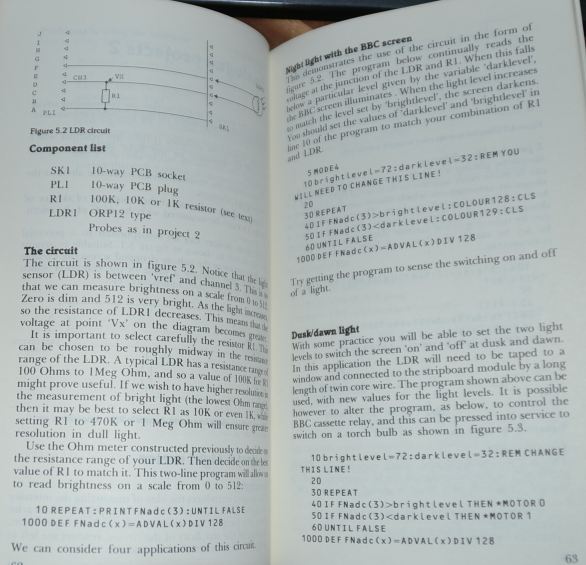

    I like this idea, I might need to find that book and read up on the Beebs Analog port. Sadly it’s not Atari compatible out of the box. It may be possible to make a converter ( I think I have seen one somewhere ) Normal Beeb joysticks were a metal rod connected to potentiometers with a single fire button similar to Dragon/Tandy joysticks. The Beeb has a built-in ADC chip so it’s ideal for Interfacing with external bits and bobs.
    This is the circuit diagram from the manual.
