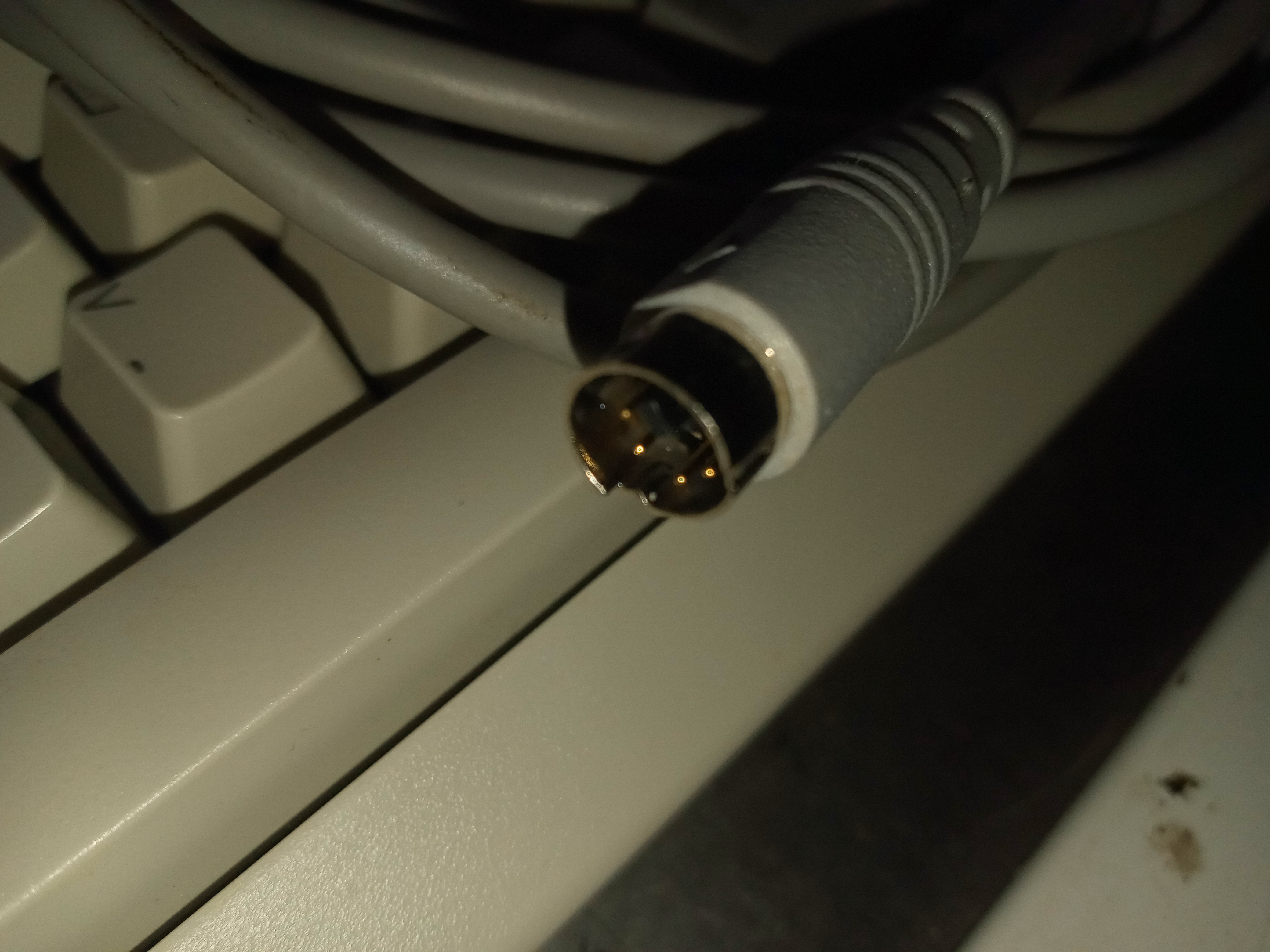

    The vintage Hi-Tek brand AT keyboard finally arrived, stuck in USPS limbo, originally supposed to be delivered by the 11th of December. Anyway, though it does seem to be mechanically close to the 800's Hi-Tek keyboard, the white plungers are smaller and rectangular, not square, like the 800's. I also don't see any leaf-spring contacts inside the plunger, like the 800's Hi-Tek keyboard. I think it might have a membrane inside actually, it feels more like my 1200XL's Mitsumi keyboard. Which is also a good thing, in as much as I have a very nice new, vintage keyboard for my PC, but no serviceable parts for my 800 Hi-Tek. So it's time to take measurements of the 800 keyboard and compare to those given to me from the Oric Atmos's Hi-tek keyboard, of which the plungers and leaf spring contacts at least looks just like the 800's.
    Anyway, to my surprise, what I thought was going to be a well-used keyboard in not-so-perfect shape looks like NOS and is in mint condition. It could have been refurbished or just very well cleaned, but they did it right, if so, it's totally clean in-between and under the keys and everywhere.
    20201230_155122.jpg 20201230_155143.jpg 20201230_155156.jpg 20201230_155214.jpg

  24. by Graham
    Certainly looks in nice condition, and a shame the key switch post etc. won't help with your 800's keyboard repair
    if you wanted to check the keyboards guts without opening it check this link https://en.wikipedia.org/wiki/IBM_PC_keyboard
    There are links off to the Type F & type M keyboards.
