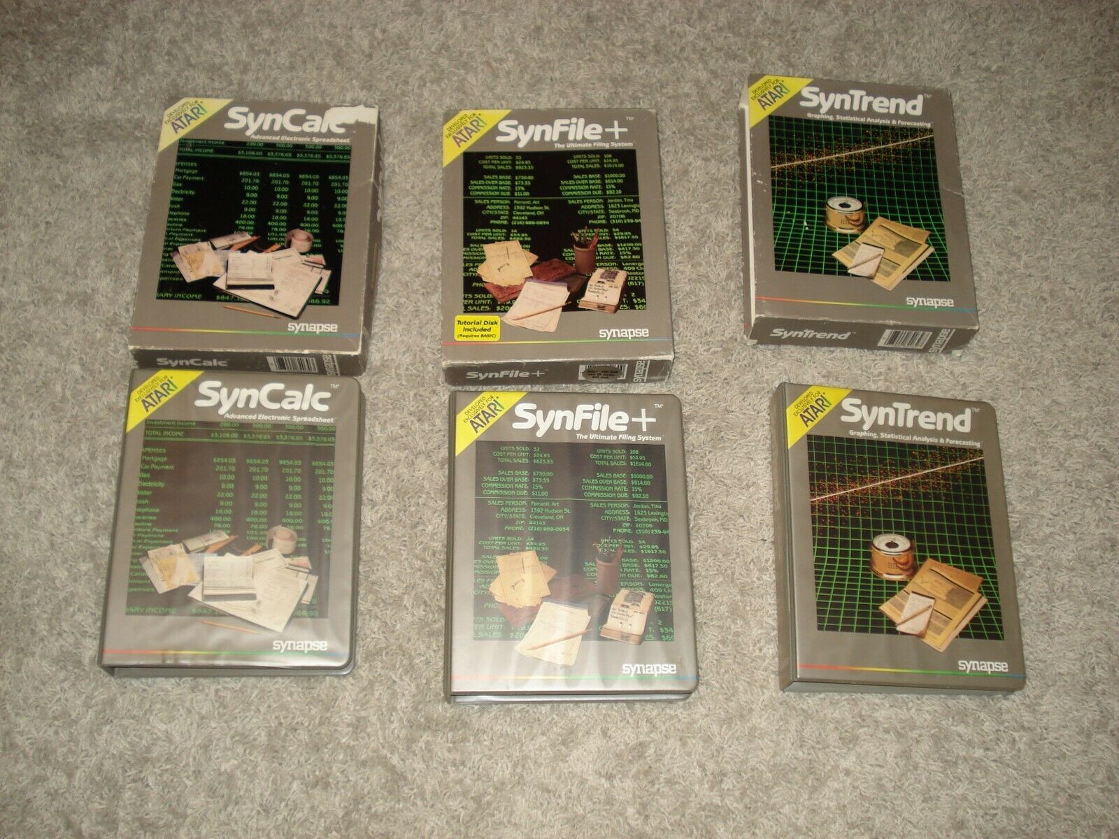

    My latest is a great deal I found on Ebay for 3 of the Syn-series programs; $24.95. usually selling for that much each! That's all the Atari spending I can afford for a while, I've been on a bit of a binge since my birthday...anything else will have to wait until Christmas, unless something urgent comes up like limited release Sophia 2 or something...that's four software packages and three hardware devices...

    Nice haul there Matt :)

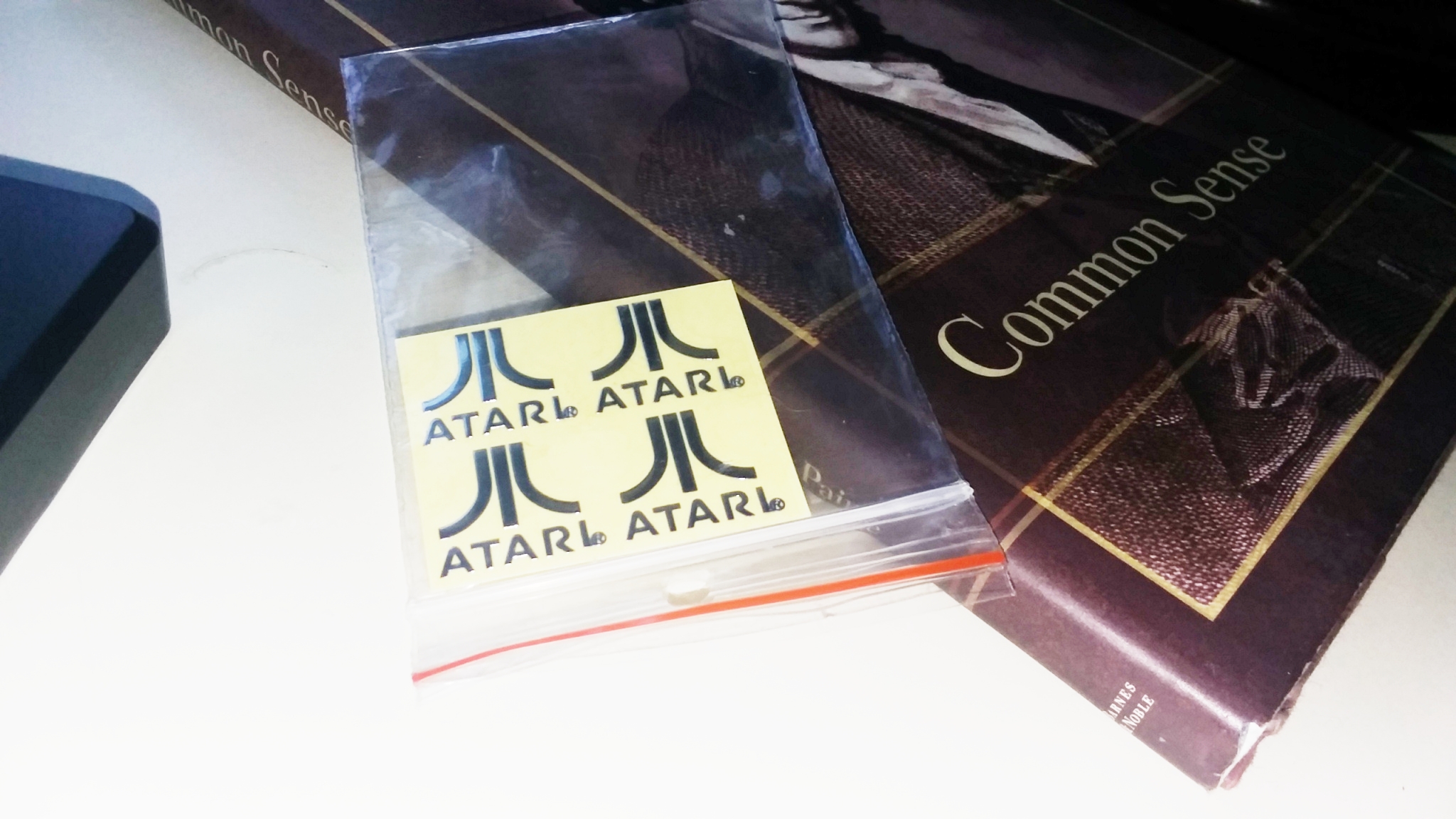

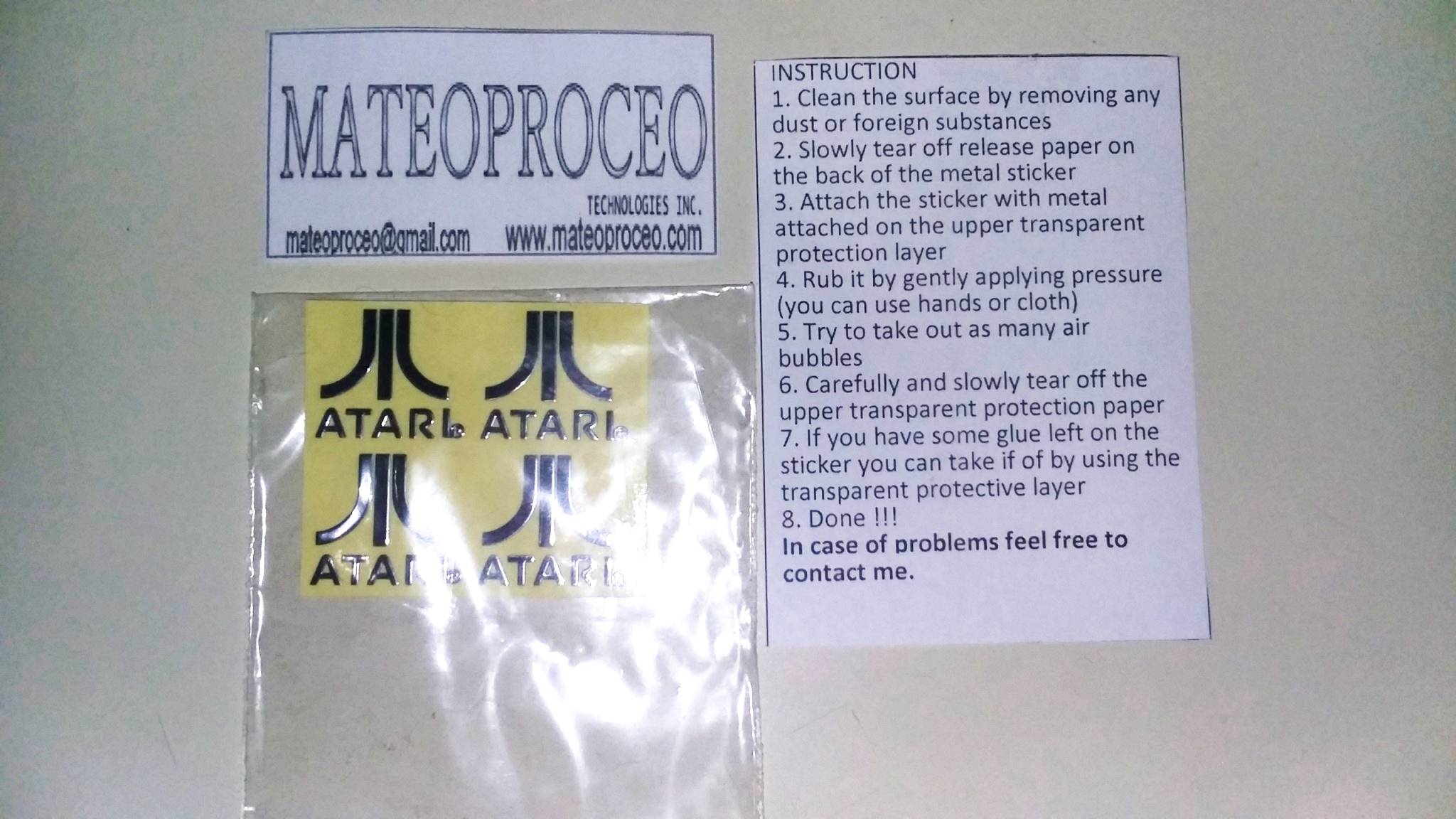

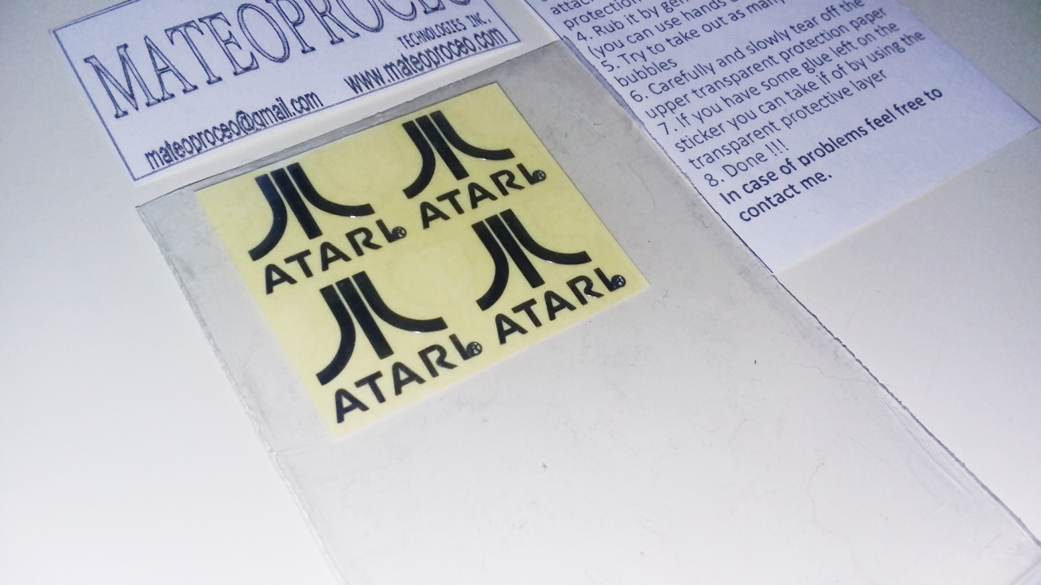

    I just got some Atari/Fuji metallic badge/labels in the mail I forgot I'd ordered from eBay. They are to add an Atari badge to custom cases I have made for devices without cases. Multiple pictures are an attempt to capture the chrome in the light...with limited success. I originally wanted to order genuine Atari badges like are on the 400/800/810, but MyAtari wants $10 each plus shipping these days which I found ludicrous, so I found these as an alternative, and 4 cost me the price of one badge from MyAtari.
    Graham, Vyper68 and Andy Barr like this.
    Very nice and very reasonable, Matt. As you say, what's the point in throwing $30-40 at a couple of Atari badges when there are much more economical alternatives available. I got a sheet of adhesive Oric badges a short while ago which cost me about 10 euros for 10 and I just colour photocopy them, carefully cut them out (so saving the originals) and pritt stick them on to various Oric peripherals and they're fine... and will outlast me, most probably.
    Anyone else got any thrifty recommendations? I remember Brenski used to produce some pretty nifty Atari 5.25" disk labels which were smart and stylish too.

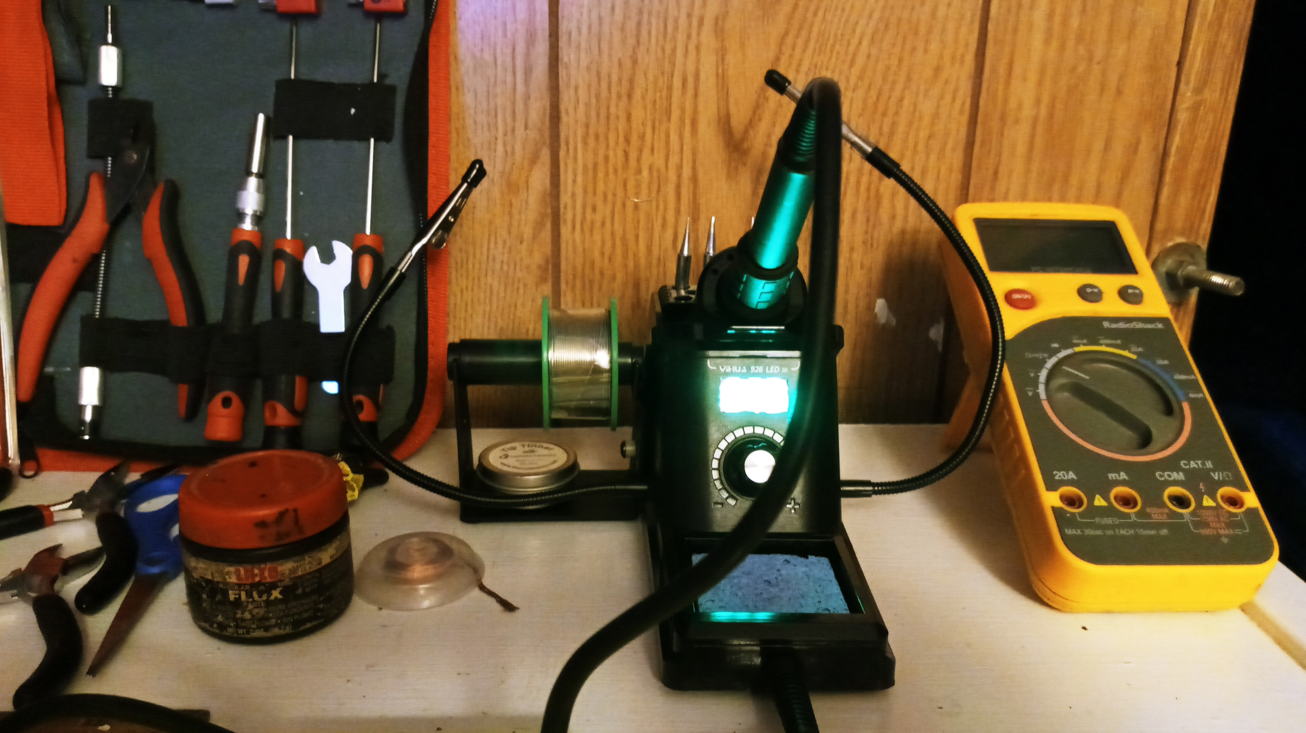

    I seem to have got in the doldrums over my collection of Atari's, I don't really have room to set them up as I would like.
    I have two main work benches in a spare bedroom, one setup, in the main as an electronics working area, but this has to double with any retro computers as well, as my preferred screen and PSU' all mounted there as well. On the other workbench, in the main it's setup as an electronics design suite, with a decent PC screen etc, plus devices to program all sorts of electronic items, design circuits, layout PCB designs etc etc. I guess I could try and make room for an Atari or so but would all need to be DVI out to make best use of the PC's screen. I'm thinking either the XEL or XLD.
    I to need different Atari setup to work the way I would like, the XEL, XLD having all the MIDI stuff, and I guess I could use a wireless PS/2 keyboard with either of these.
    The XEGS, and 800XL, 130XE all test beds for hardware (although the 800 will be used to test some stuff)
    I've been working on a replacement circuit board that fits the XEGS case as well, and designing add-ons to fit for the future, but testing on the ones I have.
    One thing I can vouch for is the mess it gets in
